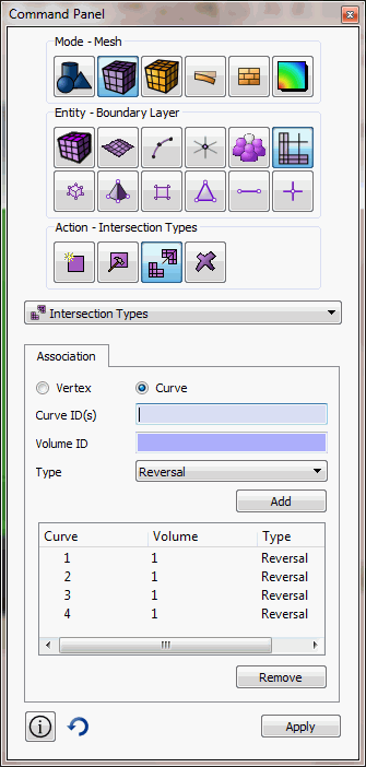

10.1 Intersection Types
In some cases, the user may want to adjust the intersection types. This could be because the automatic intersection type is not desired, or because it is not workable due to ambiguity. The four intersection types are:
end: suitable for angles between 0 and 135 degrees.
side: suitable for angles between 135 and 225
corner: suitable for angles between 225 and 315
reversal: suitable for angles 315 to 360
These intersection types may be set on a vertex/surface basis and on a curve/volume basis. Figure 547 shows the Intersections Types panel.
