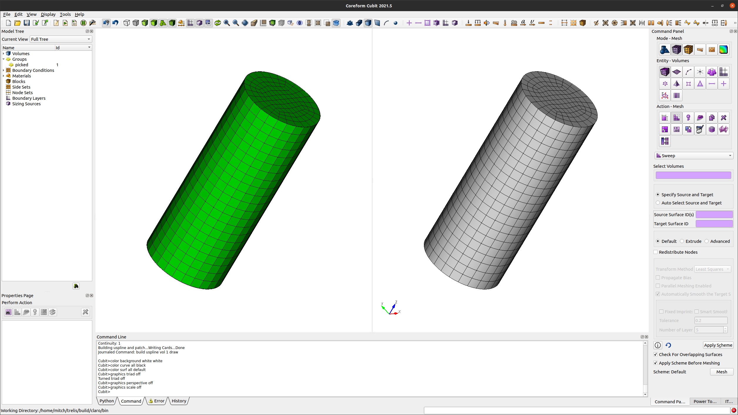

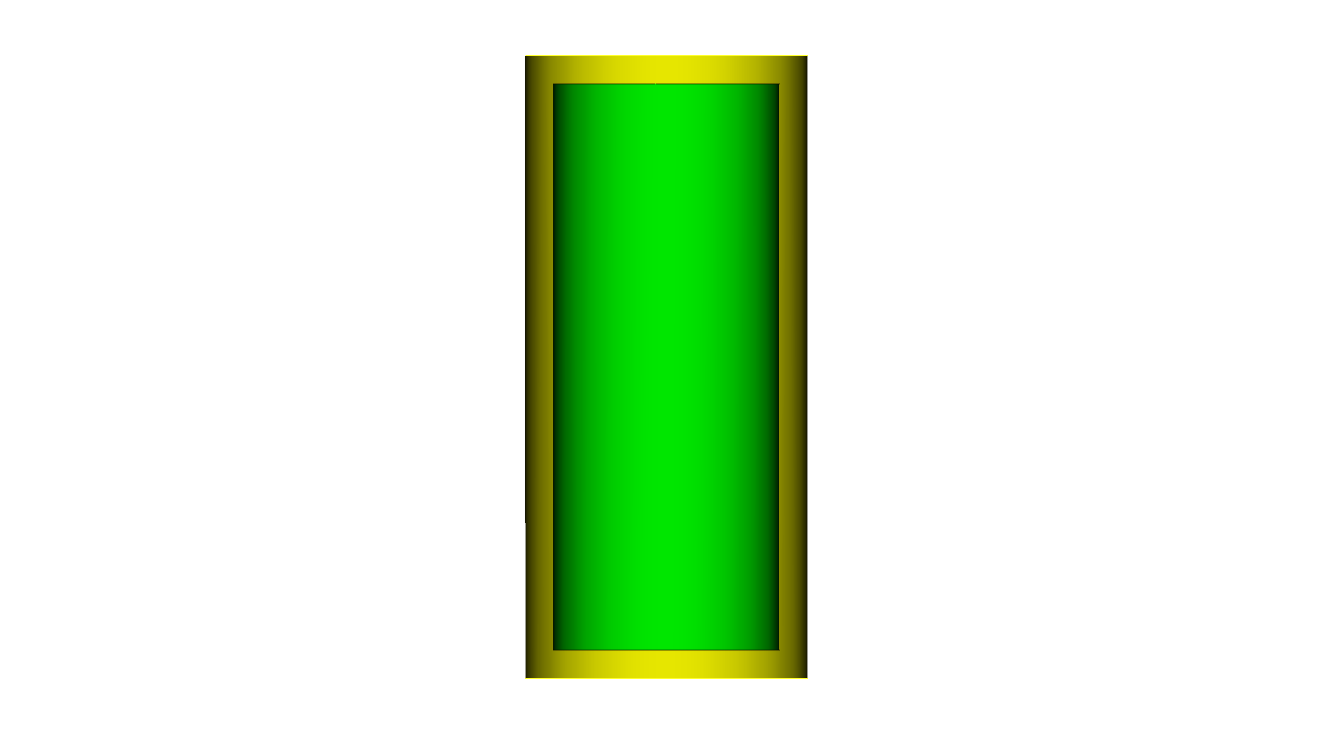

For the purposes of this guide we will consider the cylinder shown in figure 559 as the embedding mesh. Both the cylinder volume and the corresponding U-spline have an ID of 1.
Figure 559: Cylinder mesh (left) and the corresponding U-spline mesh (right)

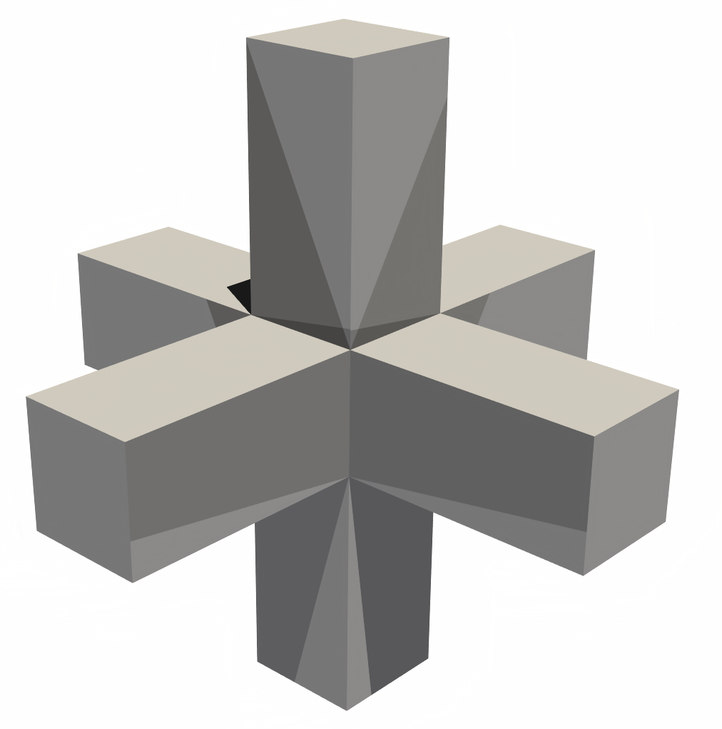

Coreform Cubit includes resource files for four reference cell types that may be used to build and slice lattice structures. The included reference cell types are jack, octettruss, truncated sphere, and pvb. These reference cells each have a 10 percent volume ratio.
Figure 560 shows the geometry of Cubit’s included lattice reference cells.
Figure 560: Included reference cell types are (in image order): jack, octettruss, truncated sphere, and pvb.

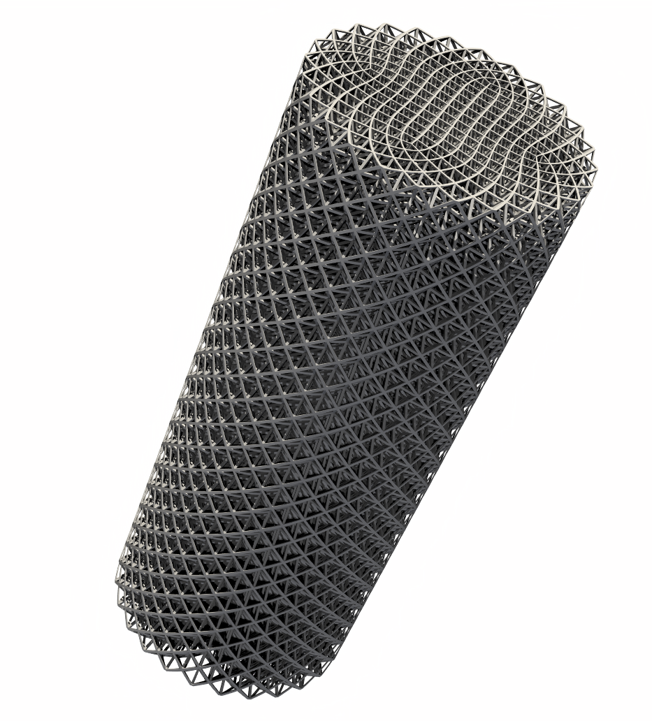

Figure 561 shows the resulting lattice, visualized in Paraview.
Figure 561: A U-spline lattice composed of the octettruss reference cell embedded in a cylindrical mesh.

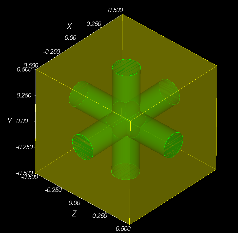

  1. Create geometry The first step in creating a user-defined reference cell tessellation is to create the geometry, either directly in Coreform Cubit or by importing from some other source.
    The valid domain for the reference cell geometry is defined as an axis-aligned box that extends from -0.5 to 0.5 in each coordinate direction. The reference cell geometry must not extend outside this bounding box, and some part of the geometry must lie on each face of the bounding box.

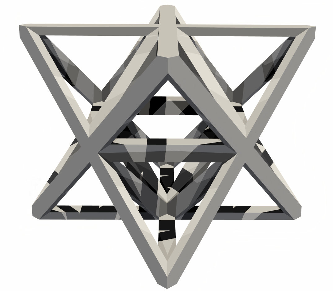

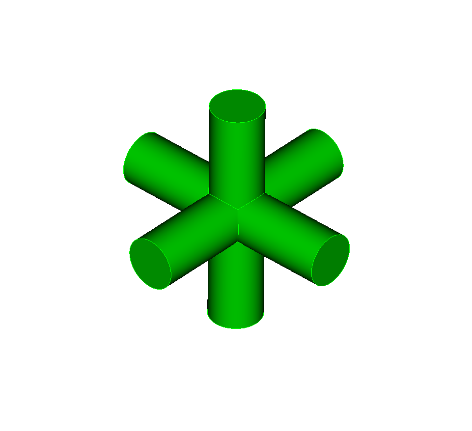

    As an example, we consider a jack reference cell with a circular cross section. Figure 562 shows the desired geometry and how it fits inside the bounding box.
    Figure 562: Top: example of a possible user-defined reference cell, in this case a jack that has been modified with a circular cross section. Bottom: The user-defined reference cell geometry shown in an axis-aligned box that extends from -0.5 to 0.5 in each coordinate direction. The reference cell geometry does not extend beyond the box but does lie on each face of the box.
    The geometry must have octahedral symmetry, which is the highest level of symmetry associated with a cube. To build a lattice structure, the reference cell only needs to have this level of symmetry at its boundaries, but for simplicity we enforce octahedral symmetry over the whole cell.

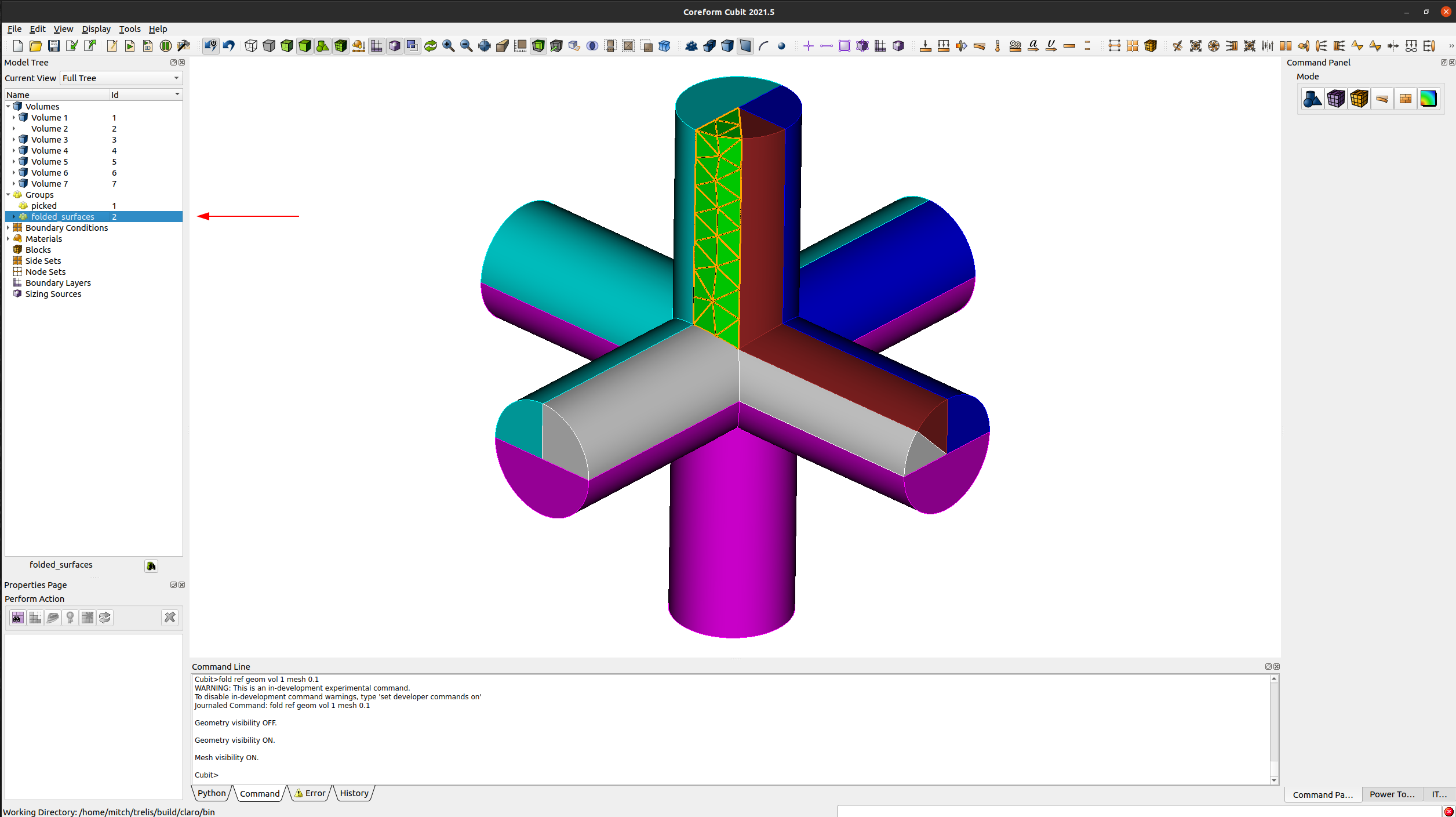

    Once an appropriate geometry for the reference cell has been defined, the fold uspline lattice ref geom command can be used to isolate the surfaces of the fundamental unit of the geometry, e.g.,
    fold uspline lattice ref geom volume <volume_id> mesh 0.1.
    The command will perform the partitions necessary to isolate the surfaces of the fundamental unit and mesh those surfaces with the specified mesh size. These surfaces will be placed inside a Cubit group titled folded_surfaces.
    Figure 563 shows the result of running the above command. Note that the mesh keyword can be omitted if the user does not want the surfaces of the reference cell to be automatically meshed.
    Figure 563: The result of folding the jack reference cell.

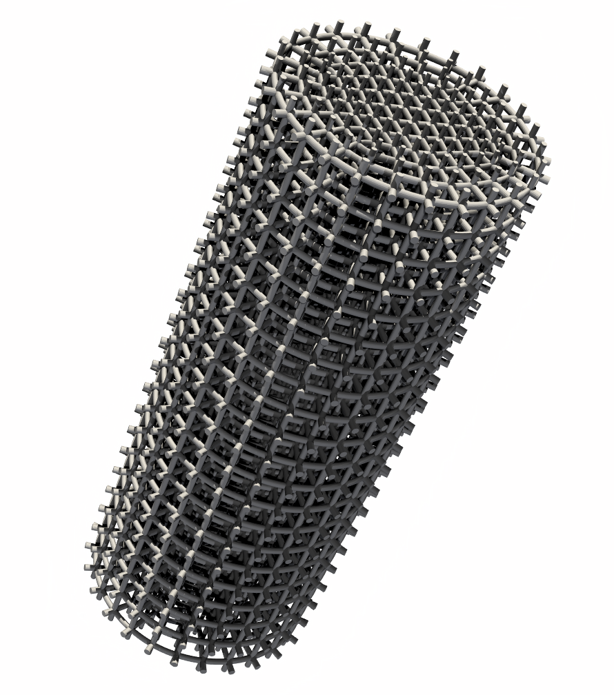

Figure 564 shows the resulting lattice visualized in Paraview.
Figure 564: A U-spline lattice of the user-defined rounded jack reference cell embedded in a cylindrical mesh.

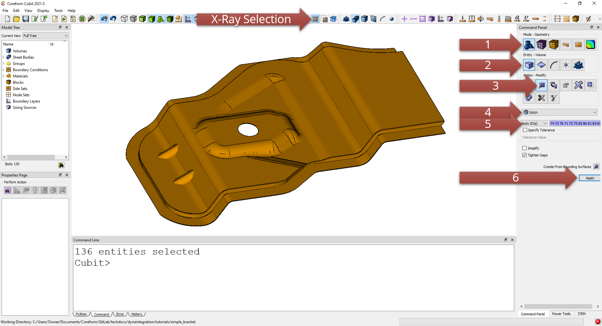

For simple models (e.g. a few CATIA parts) the user may find it most convenient to stitch these surfaces together to form a contiguous part. This process is shown in figure 567, figure 568, and figure 569.
The first step is to apply the stitching operation in Cubit by first selecting all the component surfaces of the body to be stitched.
The user may find it useful to use a drag-selection. In Windows, this is done by pressing the ctrl key while left-clicking and dragging to select multiple bodies for stitching.
When using drag-selection the user may want to enable the x-ray option, which selects all objects contained within the selection area regardless of whether they are concealed from present view by other entities. The GUI button for this option is designated by an arrow at the top center of figure 567.
Figure 567: Stitch the component bodies into a single surface by using the stitch operation in Cubit. Using the classic navigation hierarchy in Cubit, this command can be found in numbers 1 - 4 under "Mode/Geometry" > Entity/Volume > Action/Modify > Stitch. The user should then (5) change the selection mode to Body ID(s), select the bodies to stitch together (ctrl-click to select multiple bodies), and then (6) click Apply to execute.

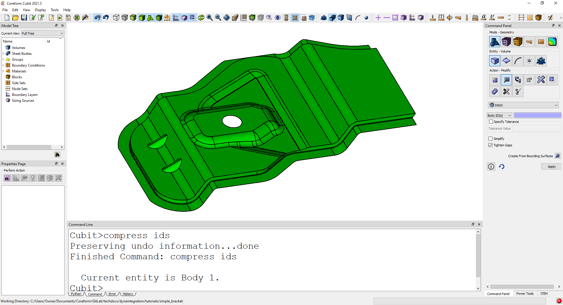

After stitching, the stitched body will be assigned a new entity ID in Cubit, determined by incrementing the largest ID previously occupied by the original multi-body STEP file. That is, as illustrated in figure 568, if a STEP import containing 136 single-surface bodies undergoes a stitching operation to make a single multi-surface body, that resulting multi-surface body will be assigned an entity ID of 137.
Figure 568: The stitch operation destroys the original bodies and creates a new body. The ID assigned to this surface is the next largest ID that was available prior to the stitch operation.
To resimplify the model’s entity IDs, execute compress ids in the Cubit command window. This will re-assign the single stitched body to an ID of 1 and increment from there.
Figure 569: Executing compress ids in the command line compresses all entity IDs to a contiguous list beginning at one.

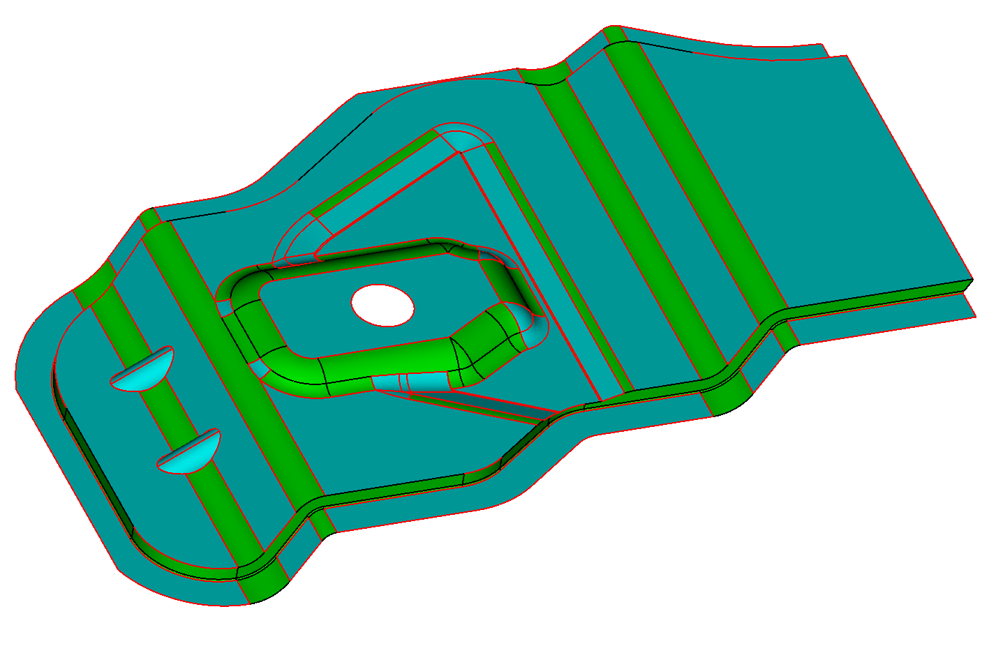

14.2.1.3 Modify BREP topology for quality meshing (Optional)
CAD geometry models often contain a large amount of unnecessary topological entities that are a result of the modeling process, but that are not required or even desirable to capture within an analysis.
These additional entities can cause the creation of very small elements, which drive the stable timestep undesirably small, as mentioned in Cleanup model geometry (Optional). Extraneous topology also often involves acute angles which can only be filled with poor quality elements.
In such cases, it is often desirable use Cubit’s real and virtual geometry editing tools to generate a new BREP topology. A representative example case follows.

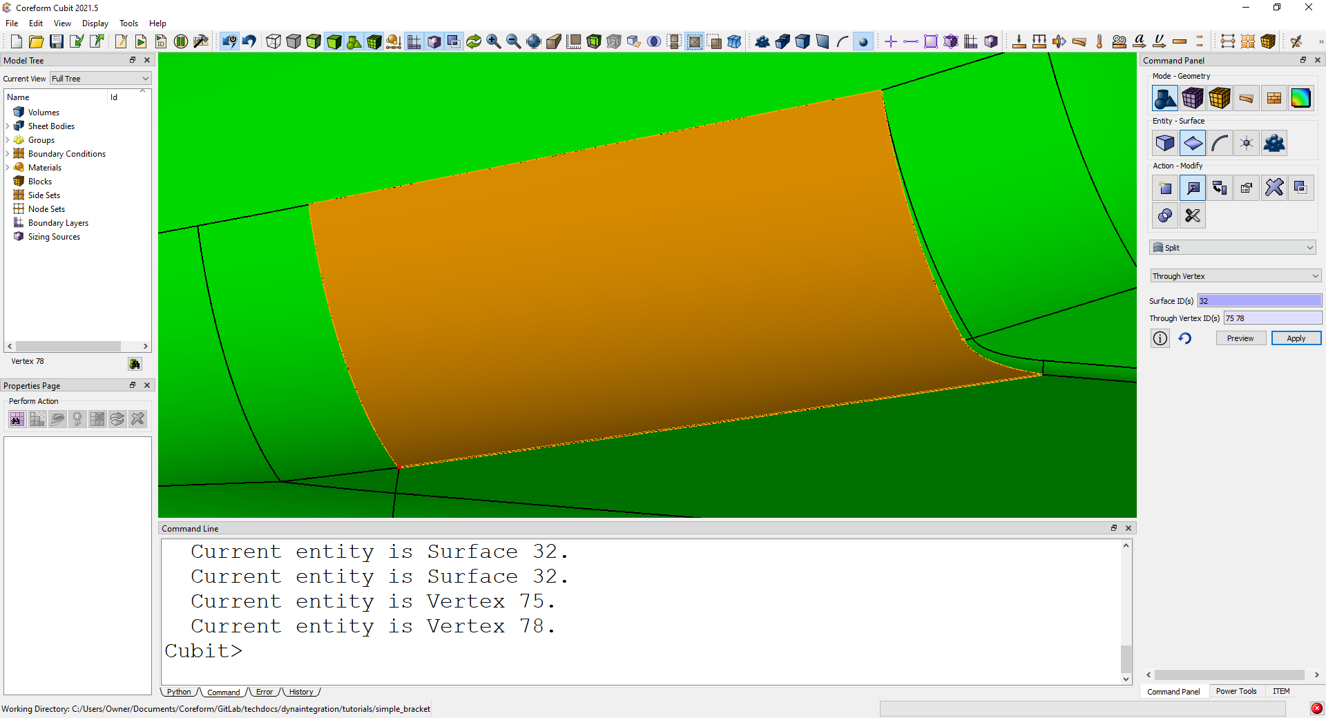

We begin by performing the real splits shown in figure 574 on two surfaces associated with multiple blend features, such that each split results in two new surfaces that align with their respective blend features.
Figure 574: Split surfaces via the command panel: Mode/Geometry > Entity/Surface > Action/Modify > Split - Through Vertex

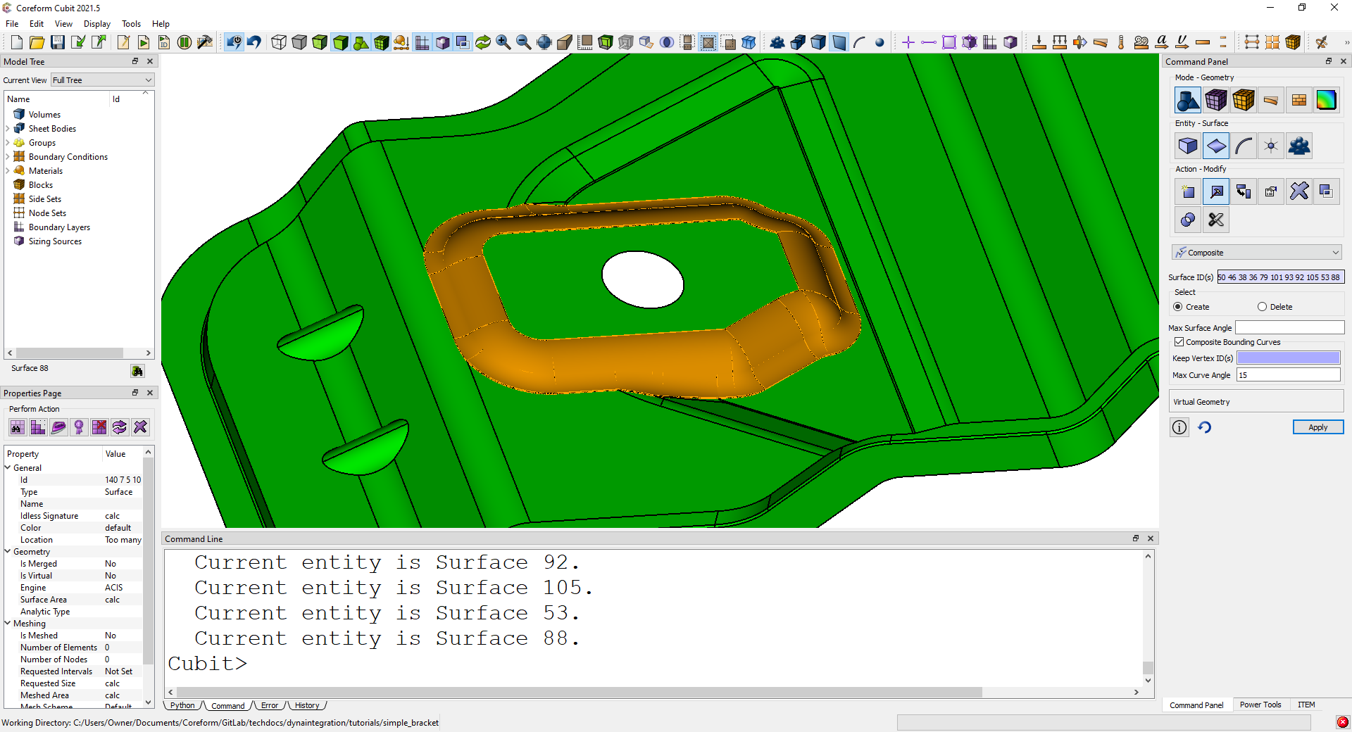

After splitting the surfaces, we begin compositing surfaces together into virtual macrosurfaces, as shown in figure 575. Once the macrosurfaces are constructed we assign meshing parameters (i.e. sizing and scheme assignments) onto the surfaces.
Figure 575: Composite surfaces into virtual macrosurfaces via the command panel: Mode/Geometry > Entity/Surface > Action/Modify > Composite
While the suppression of restrictive topological constraints by macrosurfaces can enable highly-regular paved meshes, it can also occasionally result in very distorted meshes. If this occurs, judicious application of Cubit’s mesh smoothing functionality can often restore high quality mesh elements on these domains. Figure 577 shows the result of mesh smoothing for an illustrative case.
Finally, while it is beyond the present scope, the reader may be interested in exploring manual mesh refinement within regions of interest, such as refining the elements next to a curve, as demonstrated in figure 578.

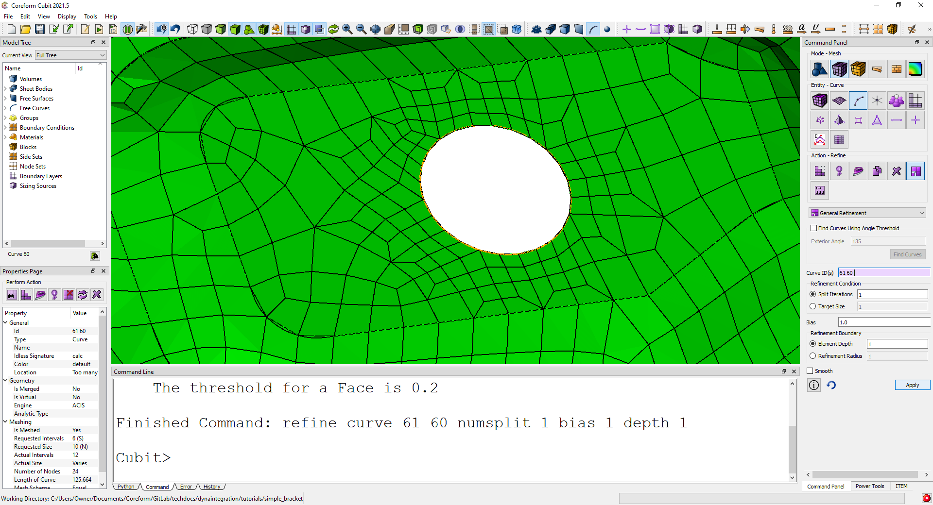

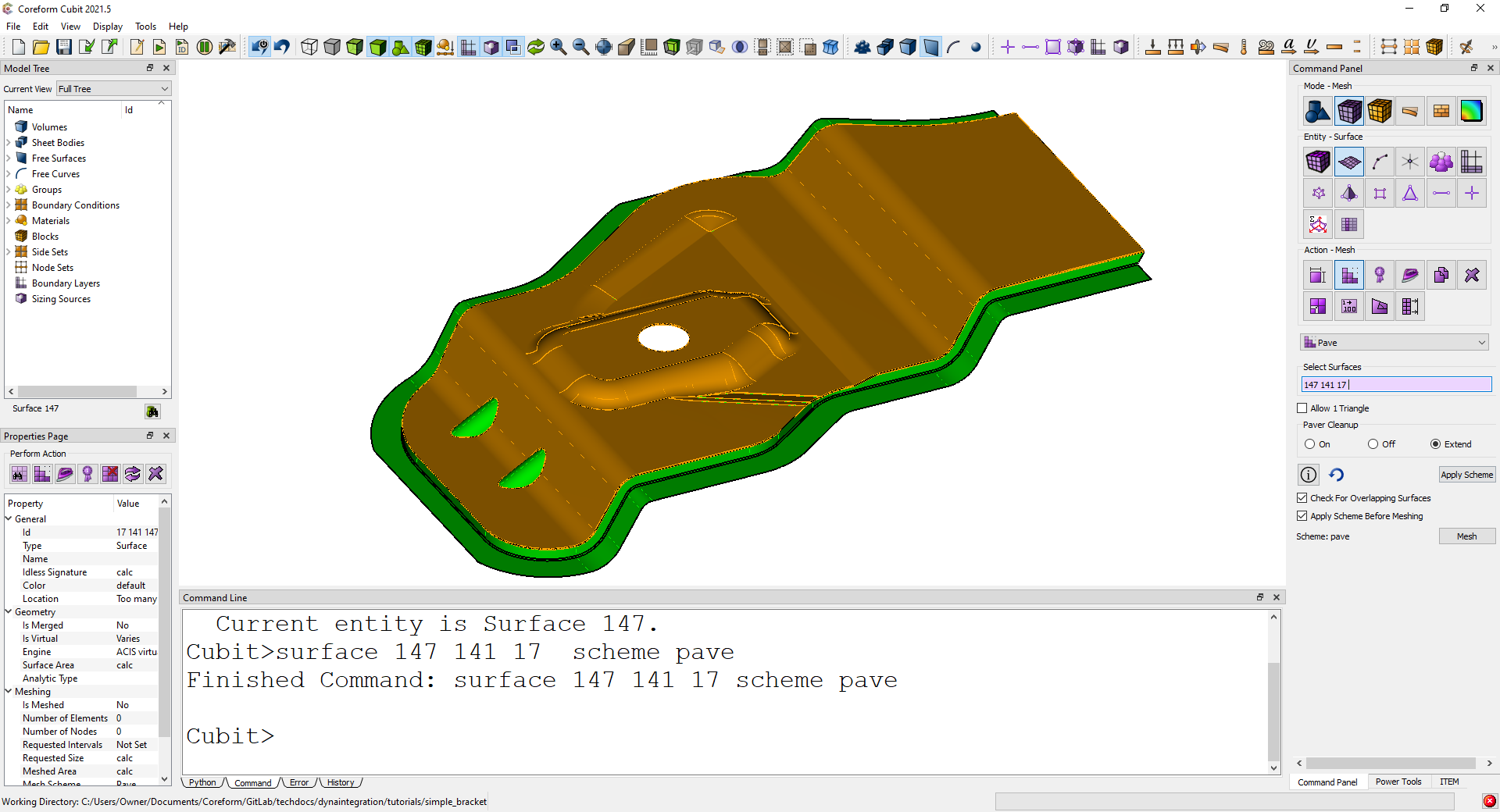

Figure 576: Assign the pave mesh scheme: Mode/Mesh > Entity/Surface > Action/Mesh > Pave. We recommend using the Pave > Paver Cleanup > Extend option to minimize extraordinary points in the resulting mesh.

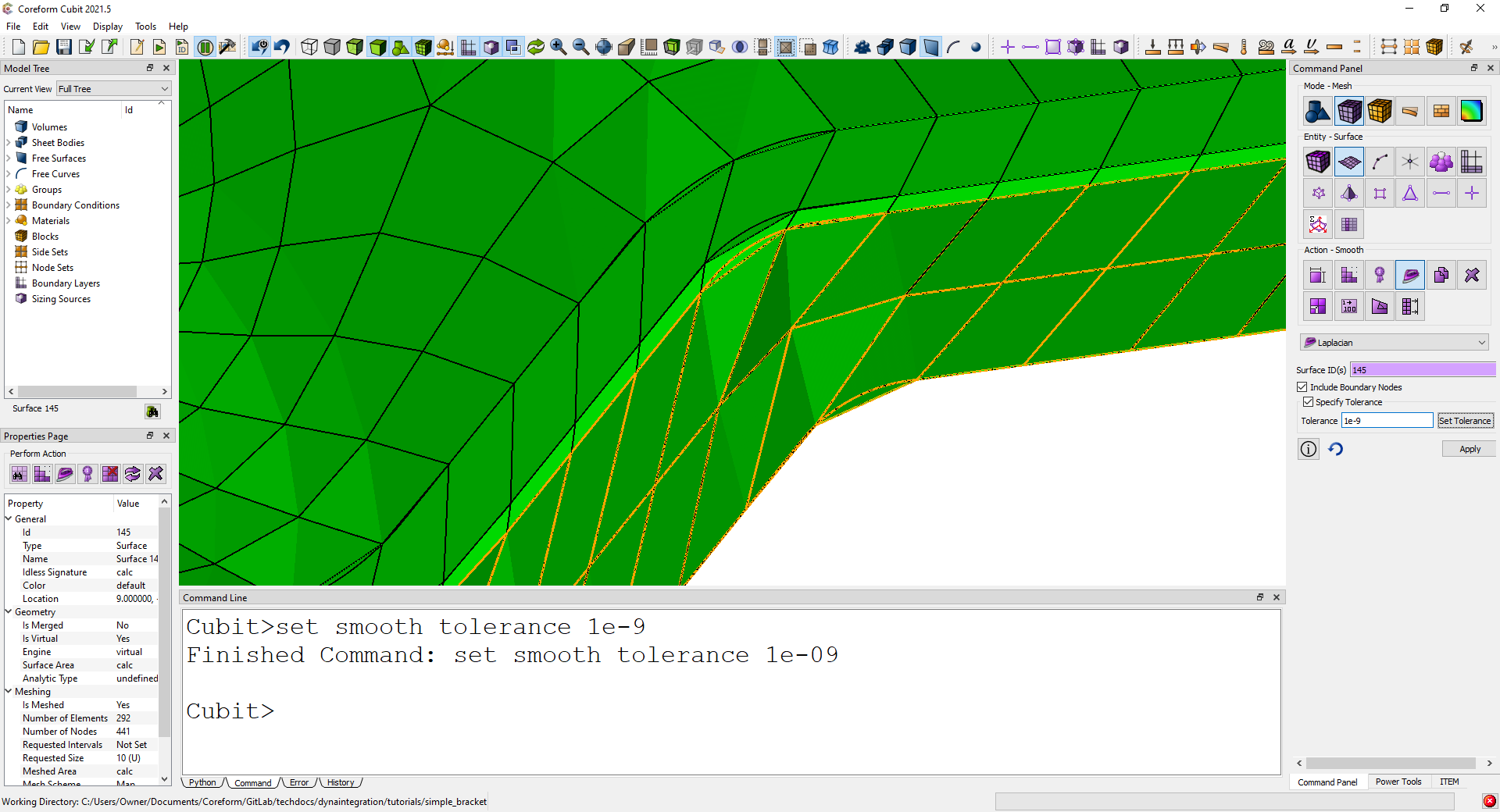

Figure 577: Smoothing a distorted region using the Laplacian smoothing scheme, via the GUI under Mode/Mesh > Entity/Surface > Action/Smooth > Laplacian. By further electing to Include Boundary Nodes we allow these elements the freedom to fully smooth themselves. This option does not always yield desireable results. We also specify a tight tolerance for the smoother via Specify Tolerance > Set Tolerance which sets a global, persistent value. If the user iterates the mesh generation process, they may wish to reset this tolerance when finished with their current smoothing operation so that subsequent meshing operations don't perform auto-smoothing to this same tolerance.
Figure 578: Optionally, the user can locally refine the mesh using a quasi-local conforming mesh refinement. In this case, the user has used the GUI tool under Mode/Mesh > Entity/Curve > Action/General Refinement. Equivalent functions also exist for Entity/Volume, Entity/Surface, Entity/Vertex, Entity/Quad, Entity/Edge, Entity/Node.

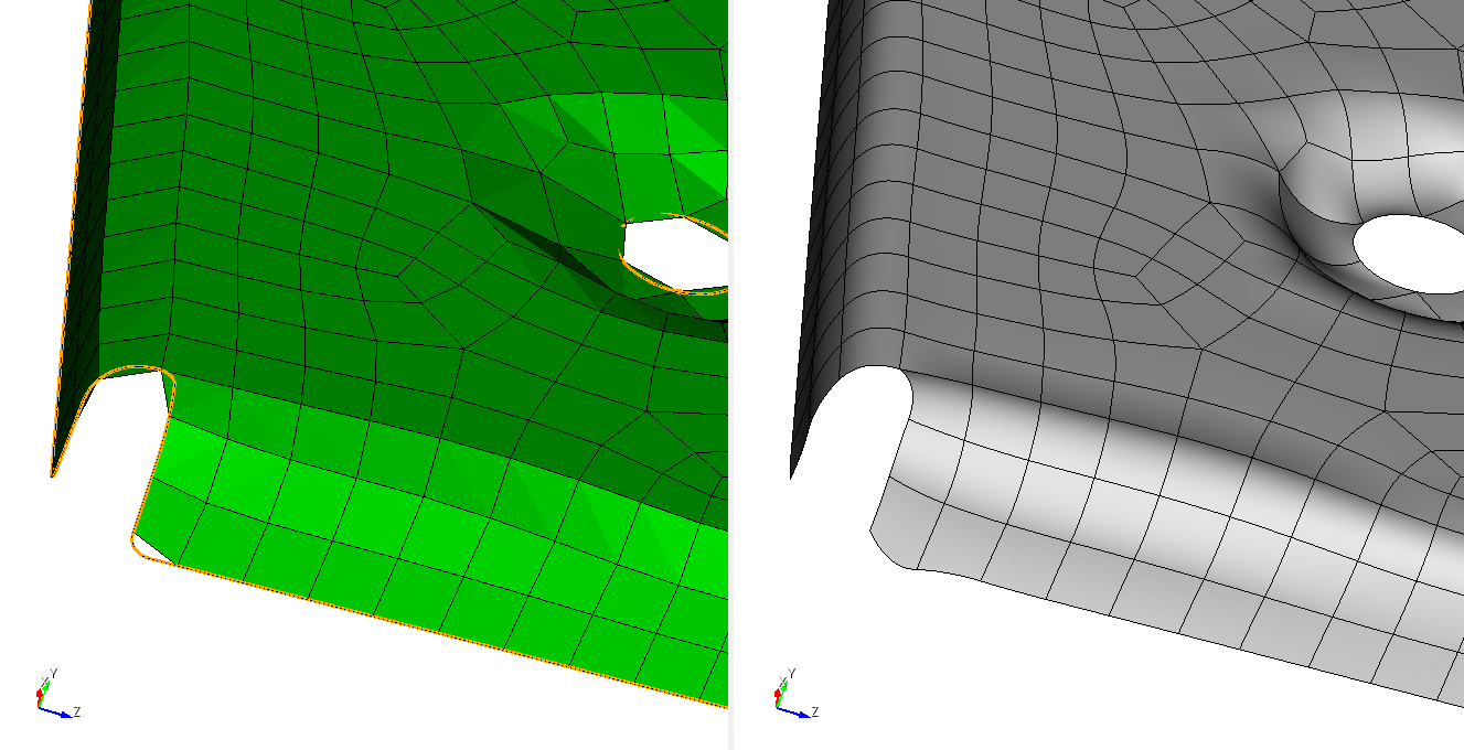

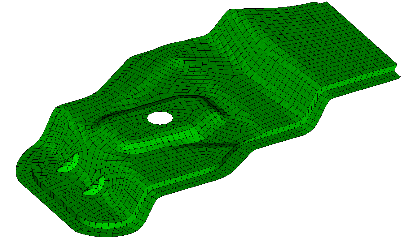

14.2.1.4 Mesh model geometry
Currently Cubit only builds U-splines on all-hex swept volumetric and all-quad surface meshes. Within these constraints, mesh parameter options the analyst may wish to explore include:

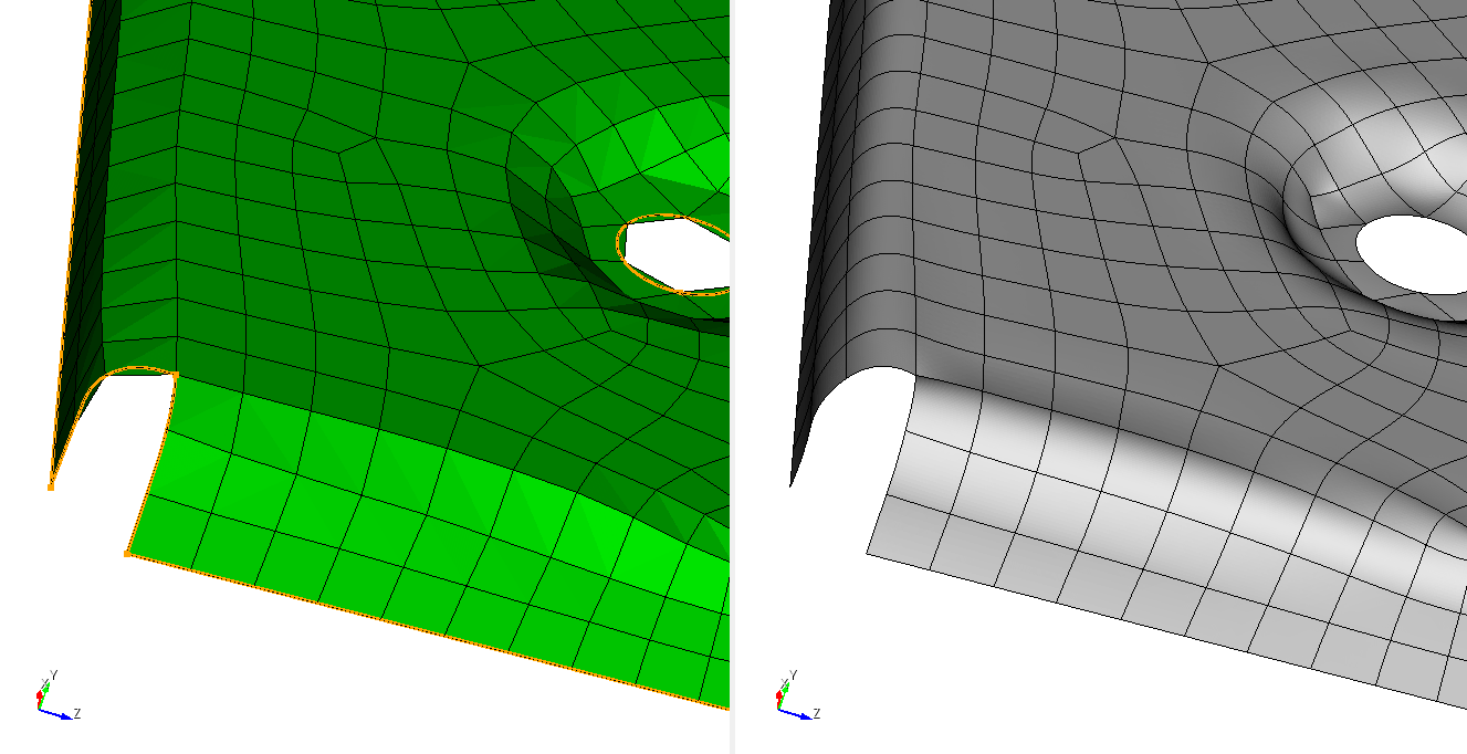

Figure 579: Comparing the effect of the options for paver cleanup setting. The first image shows the result of the default on option. The second shows the effect of the extend option.

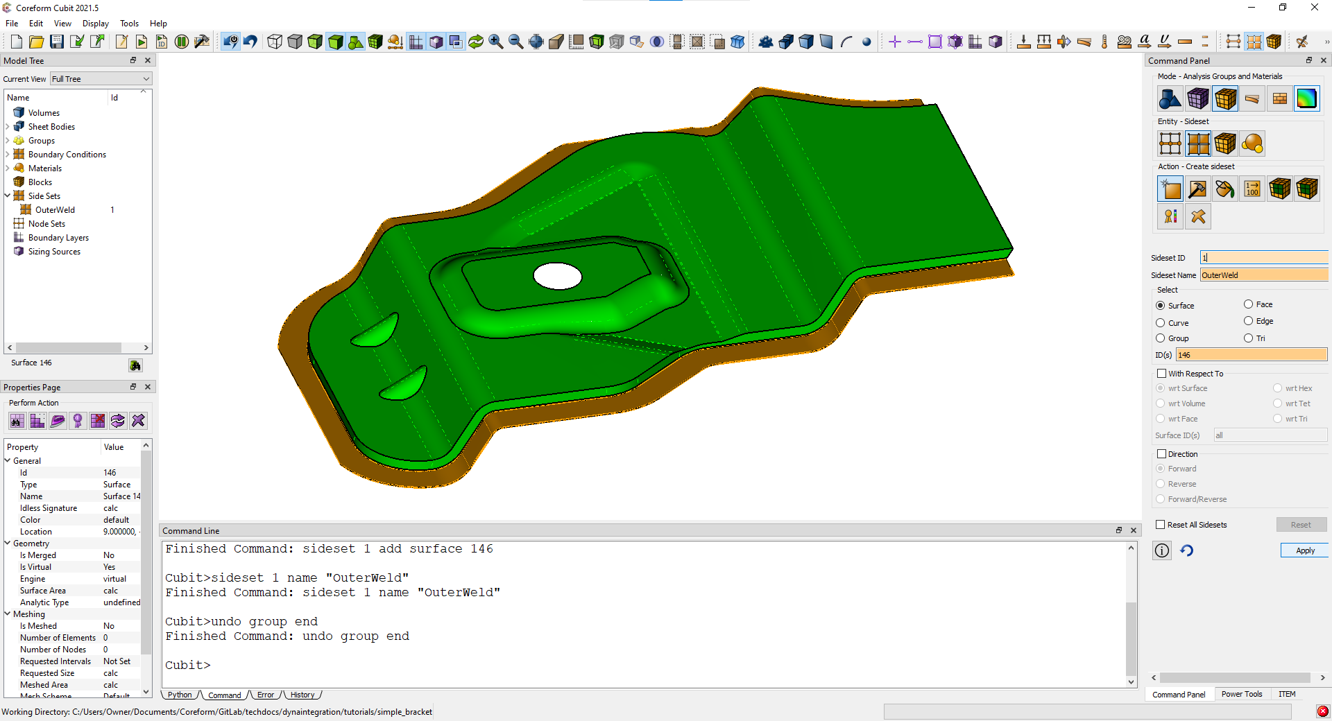

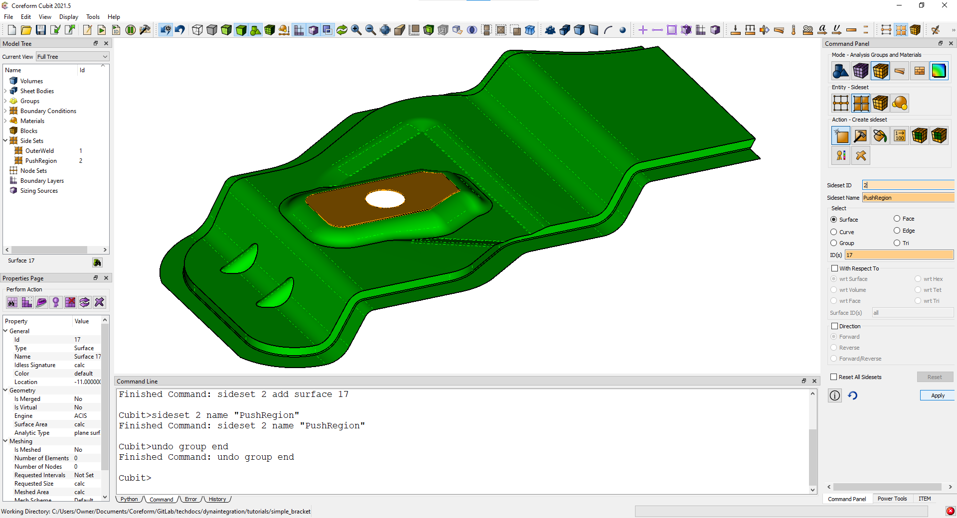

14.2.1.5 Create subdomains for *SET_ keywords

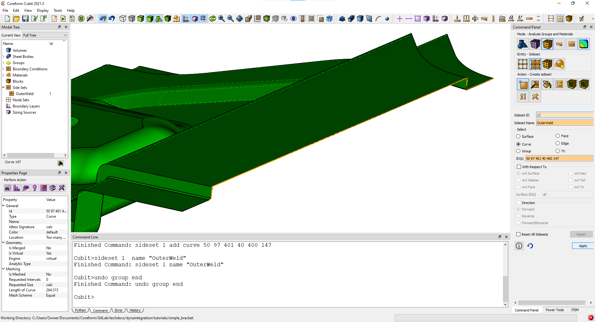

After generating the mesh, we create Cubit sideset objects, which can consist of curves and/or surfaces which will later be used by Cubit to export LS-DYNA *SET_NODE_LIST_TITLE keywords. These *SET_NODE_LIST_TITLE keywords can then be referenced by relevant boundary/load conditions in LS-DYNA.
Tools to create and modify sidesets can be found in Cubit under the command panel, Mode/Analysis Groups and Materials > Entity/Sideset > Create sideset and Mode/Analysis Groups and Materials > Entity/Sideset > Modify respectively.
To illustrate, we will create two displacement boundary conditions:
  1. An encastre condition along the outer region, as shown in figure 580, of the part that approximates a weld to a significantly stiffer part, and
  2. A prescribed displacement on the inner surface, as shown in figure 581, that approximates a weld to a significantly-stiffer part that will press on the surface.
Creating sideset 1, "OuterWeld", with an initial surface selection.Adding the selected curves to sideset 1.
Figure 580: Using the Cubit GUI to create the sideset corresponding to a *BOUNDARY_SPC_SET_ID keyword that will approximate a welded, stiff boundary along the outside of the part. In this case the user has used the command panel tool under Mode/Analysis Groups and Materials > Entity/Sideset > Action/Create sideset.
Figure 581: Using the Cubit GUI to create the sideset corresponding to a *BOUNDARY_PRESCRIBED_MOTION_SET_ID keyword that will approximate a displacement on the selected interior surface. The outer boundary of this surface will need to be set to by adding the bounding curve to a Cubit group entitled cf_crease_and_project_entities.

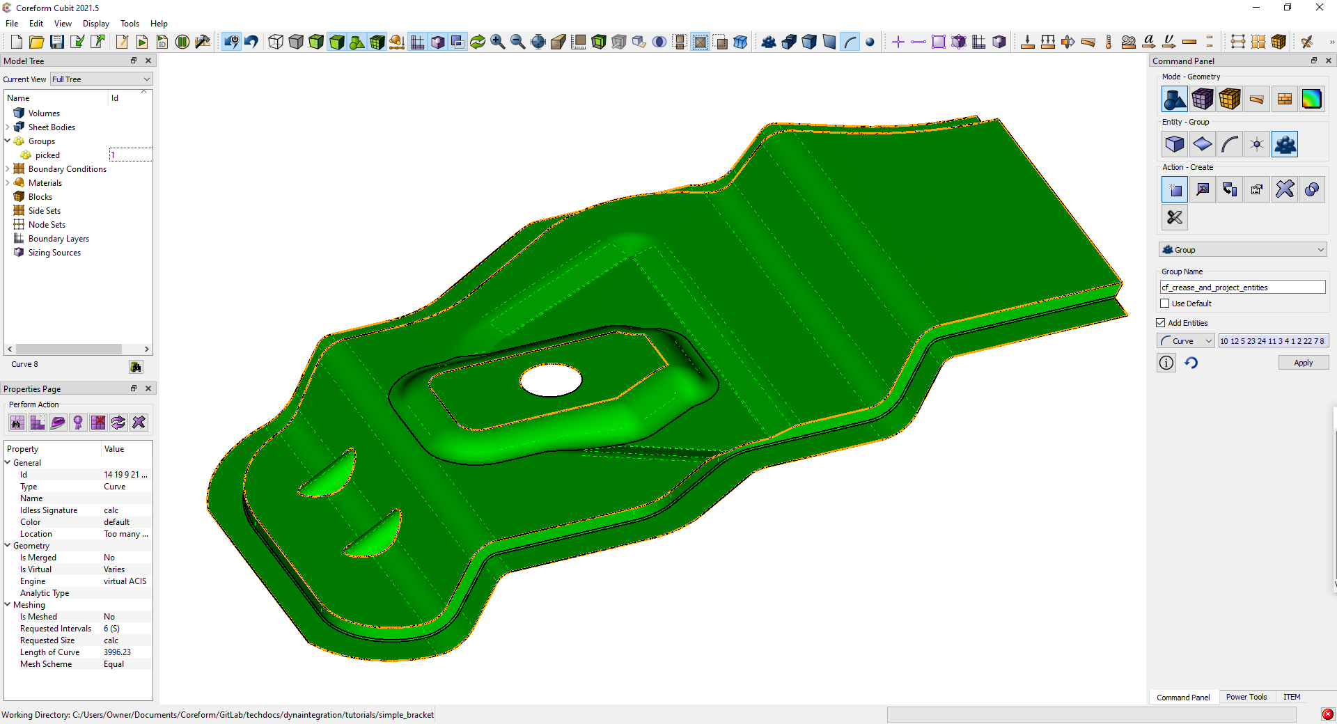

When the initial mesh layout is complete, U-spline construction can begin. A critical initial task is to identify all Bézier interfaces that should be assigned continuity, or creased.
Creasing may be required when:
  1. the underlying geometry is not smooth, or
  2. we wish to apply a Dirichlet boundary condition, either on the interface in question, or on a surface enclosed by a loop of Bézier interfaces, as described in Create subdomains for *SET_ keywords and figure 581
Recall that unlike the Flex Representation Method (FRM) being developed by Coreform, traditional FEA programs apply boundary and load conditions directly on constituent mesh entities such as nodes and element faces. Thus a mesh whose basis functions interpolate the applied condition’s domain is required. This is in stark contrast to FRM, which weakly enforces boundary and load conditions.
To designate Bézier interfaces for creasing, we (1) select the curves that contain the Bézier element interfaces that need to be creased and (2) assign them to a crease group, which the U-spline algorithm in Coreform Cubit automatically consumes as input.
We create the group by executing build uspline crease group in the Cubit command line. This command creates a group called cf_crease_and_project_entities and searches for candidate curves (and vertices) to include in this group.
Alternatively, the user can do this manually, creating the group via the command create group cf_crease_and_project_entities and then manually adding (or removing) entities to the group by selecting them in the model-viewer as we demonstrate in figure 582.
Note that in figure 582 we have selected a loop of curves that bound a surface. That surface is geometrically smooth with its neighboring macrosurface. We have done this because we intend to apply a boundary condition on this surface and, per the previous discussion, need a interface along this surface’s boundary.
Figure 582: Creating the "cf_crease_and_project_entities" group in the GUI via: Mode/Geometry > Entity/Group > Action/Create > Group
Once this group has been created we proceed with building the U-spline on the mesh.

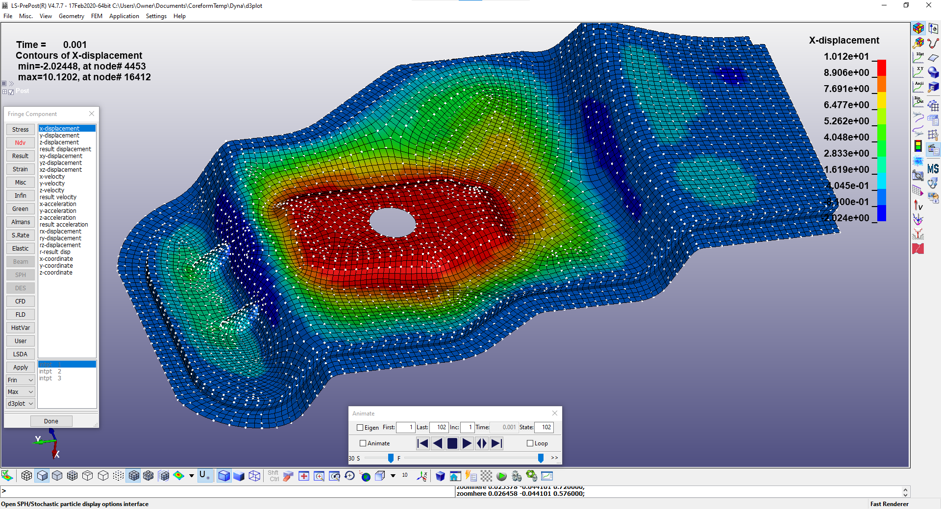

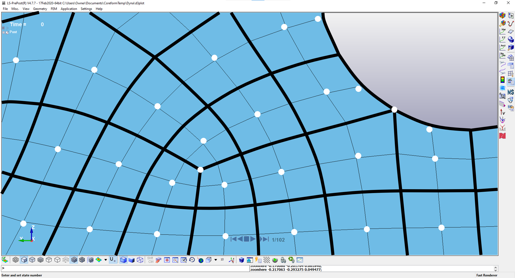

Simulation output files can be visualized in LS-PrePost as shown in figure 585, where we display a fringe plot of displacement in the -direction at the final timestep.
Note that the Bézier elements will be rendered as though they were an element with interpolatory nodes, thus a single quadratic Bézier element will be drawn as though it were a 2 x 2 element. In figure 586, we provide a schematic of how to interpret the rendered mesh in LS-PrePost.
Figure 585: Displaying a fringe-plot of the results at the final timestep of the analysis.
Figure 586: A marked-up image of the IGA results in LS-PrePost. The thin black lines are the actual lines plotted in LS-PrePost and subdivide each Bézier element, whose boundaries have been manually drawn over with thick black lines, into a 2 x 2 partitioning. Note that behind each thick line that has been drawn on the Bézier element boundaries, there is a thin black line. U-spline control points are rendered as small white dots, over which a large white dot has been manually drawn to assist with visualizing in this figure.
