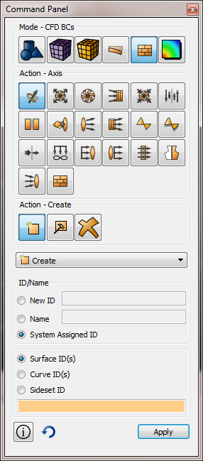

The GUI Command Panel for creating an Axis boundary condition is shown below.
Figure 483:
Cubit can export models to the Fluent mesh format and supports defining the above CFD boundary conditions. Only the region on which the BC acts can be defined in Cubit. The data associated with each boundary condition (pressure, velocity, mass values) is not defined within Cubit and must be assigned using a CFD model editor, such as Fluent. The following shows the commands for creating and modifying some sample CFD boundary conditions. To delete them, use the delete command (see Miscellaneous Commands).

  2. Click on the create or modify action button.
  3. Specify ID/name, entity list and entity ID(s).
  4. Enter any other appropriate settings.
  5. Click apply.

To create or modify a convection
  1. On the Command Panel, click on FEA Bcs and then convection.
  5. Click apply.

The BC delete keyword combination is used to delete boundary conditions. The current list of all entities that can be deleted using this command were shown in Table 1. Cubit currently has no ’undo’ command to ’undelete’ a boundary condition deletion. To delete a boundary condition
  1. On the Command Panel, click on FEA Bcs or CFD Bcs.
  2. Click on any option from the Entity menu.
  3. Click on the delete action button.
  4. Enter the appropriate settings.
  5. Click apply.
