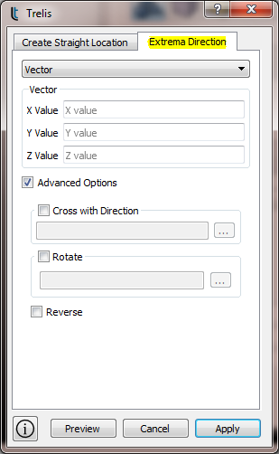

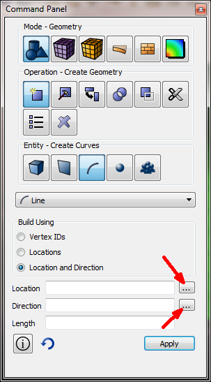

3.6.1 Command Panels for Specifying Location, Direction, Plane, and Axis
The command syntax for specifying location, direction, plane, and axis are some of the most powerful, yet complex in the Cubit command language. On those command panels where this information is required popup dialogs are available to assist the user define needed information. The dialogs are each derived from the same base parent, so their behavior is similar.
For example, the command for creating a simple curve (shown above) includes options for specifying a location and direction for the curve. The command panel for this command is shown below. Notice the fields for specifying location and direction. Each includes a button which, when pressed, will launch a dialog that includes all the details for a simple location of direction, or a very complicated location and direction. The dialogs are shown below.
Figure 91:
The location, direction, plane, and axis commands often allow additional location, direction, plane, and axis syntax tokens as part of the definition. When this happens the ’child’ dialog’ will spawn a new tab. As the user hits the Apply button, the tokens will be written to the appropriate field on the parent dialog. An example below shows a direction dialog shown as a new tab in the location dialog. The new direction tab is highlighted in yellow.
Figure 92:

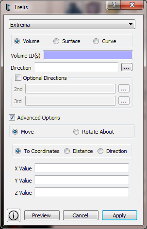

3.6.2.8 Extrema
Extrema {Curve|Surface|Volume|Body|Group} <range> [Direction] {options} [Direction {options}] [Direction {options}]
The extrema option returns the location of the maximum value, on the specified entity or group, in the specified direction. For example, the following places a vertex on a surface at the point of maximum y-axis value.
create vertex location extrema surf 1 direction y

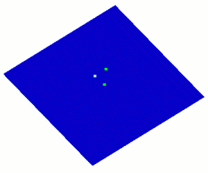

3.6.2.10 Between
Between {Location <options> Location <options> } | {Location <options> Project {Curve|Surface} <range>} [Stop] [Fraction <val>]
The between option finds a location that is between two locations or a location and an entity. An optional fraction can be given to specify the fractional distance from the first location to the second location or entity. For example, the following will draw a location at (5, 0, 0):
draw location between location 0 0 0 location 10 0 0
The following will draw a location at (2.5, 0, 0) - 25% of the distance from (0, 0, 0) to (10, 0, 0):
draw location between location 0 0 0 location 10 0 0 fraction .25
The second item can be an entity:
draw location between location 0 0 0 vertex 2
draw location between location 0 0 0 surface 1
In the second case, location (0, 0, 0) is projected to surface 1, then the location that is between (0, 0, 0) and the projected location is found.
Of course, any valid location can be used in the command. In the following example a location at the top center of the brick is found:
brick x 10
draw location between location bet vert 3 vert 2
location bet vert 8 vert 5
The first location is between vertices 3 and 2, and the second location is between vertices 8 and 5.

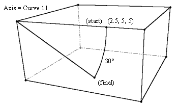

3.6.2.12 Swing
Swing [All] [About] Axis {options} Angle <ang>
Any location can be "swung" (rotated) about an axis by a certain angle. (See the section on specifying an axis for the axis syntax). As with moves, multiple swings can be strung together. The following example rotates the location (2.5, 5, 5) thirty degrees about an axis defined by Curve 11. Note that the right-hand rule is used to determine the direction of the swing about the axis.
draw location 2.5 5 5 swing about axis curve 11 angle 30
Figure 93: Swinging a Location

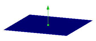

Figure 96:
Figure 1 - Tangents to a Curve

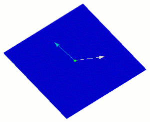

3.6.4.6 From Location
[From] {Location {options} | Node|Vertex <id>} [Project] {Location {options} | [Entity]
{Node|Vertex|Curve|Surface} <id>}
The from location option finds a direction that is from one location to another or from a location to an entity. If the second specification is an entity, the first location is projected to the entity to find the direction.
draw direction from vertex 1 vertex 2
draw direction from location on curve 1 fraction .5 surface 3
Note that when using an entity for the second specification, the Project and Entity keywords are generally optional. However, it is sometimes necessary to remove ambiguity from the previous location specification. For example, the following will not parse correctly:
draw direction location on curve 1 distance 2 surface 3
In this case, the location on the curve is parsed as a distance 2.0 from surface 3. Instead, the desired behavior is to find the location on curve 1 as a distance of 2.0 along the curve from the start of the curve, and project it to surface 3 to find the direction. The following commands (all equivalent) achieve this behavior:
draw direction location on curve 1 distance 2 project surface 3
draw direction location on curve 1 distance 2 entity surface 3
draw direction location on curve 1 distance 2 project entity surface 3

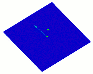

3.6.4.10 Previewing a Direction
Sometimes it is helpful to preview a direction before using it in a command. A direction may be previewed using the Draw command. The direction options are described above. See Specifying a Location for a list of location options.
Draw Direction {direction_options} [Location (location_options)]

3.6.6.1 Location and Normal Vector
{Location|Vertex|Node} <origin> Direction <normal>
The first way to specify a plane is to specify a starting point and a direction vector:
draw plane location 1 2 3 direction 0 1 1
draw plane vertex 1 direction tangent at curve 1
Figure 99: Specifying a plane with a location and surface normal

It is also possible to select an origin point and 2 direction vectors on the plane.
Figure 100: Specifying a plane with a point and 2 in-plane vectors
3.6.6.3 Two Locations and Vector on the Plane
{Location|Vertex|Node} <2 locations> Direction <vector on the plane>
You can also specify 2 locations and 1 direction on the plane to define the plane.
draw plane vertex 1 2 direction 0 1 1
Figure 101: Specifying 2 locations and 1 direction on the plane
3.6.6.4 Three Points on the Plane
{Location|Vertex|Node} <3 locations>
A plane can be defined by three locations, vertices, or nodes. The locations are specified using Location Specification.
draw plane vertex 1 2 3
draw plane vertex 1 2 location 3 4 5
Figure 102: A plane specified by three points

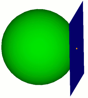

3.6.6.5 Plane defined by a Surface
Surface <id> [At Location <loc>]
The surface option uses and existing surface to define the plane. If it is not a planar surface, the optional location specifier can be used to find the tangent plane of a specific point on the surface.
draw plane surface 1 at location 4 0 0
Figure 103: Specifying a Tangent plane to a Surface

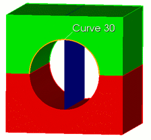

3.6.6.6 Plane Normal to a Curve
[Normal To] Curve <id> [loc on curve options]
The Normal to Curve option allows you to define a plane by using an existing curve. The direction of the curve will define the surface normal of the new plane. The optional location argument specifies which point to use on the curve if it is not a straight curve. If no location is specified the plane will originate at the midpoint of the curve. See Specifying a Location on a Curve for more information on location options.
brick x 10
cylinder radius 3 z 12
subtract body 2 from 1
webcut body 1 xplane
draw plane normal to curve 30
Figure 104: Draw Plane Normal to Curve
