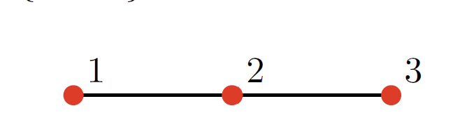

Figure 617: Node ordering for a BEX_CURVE element with degree .

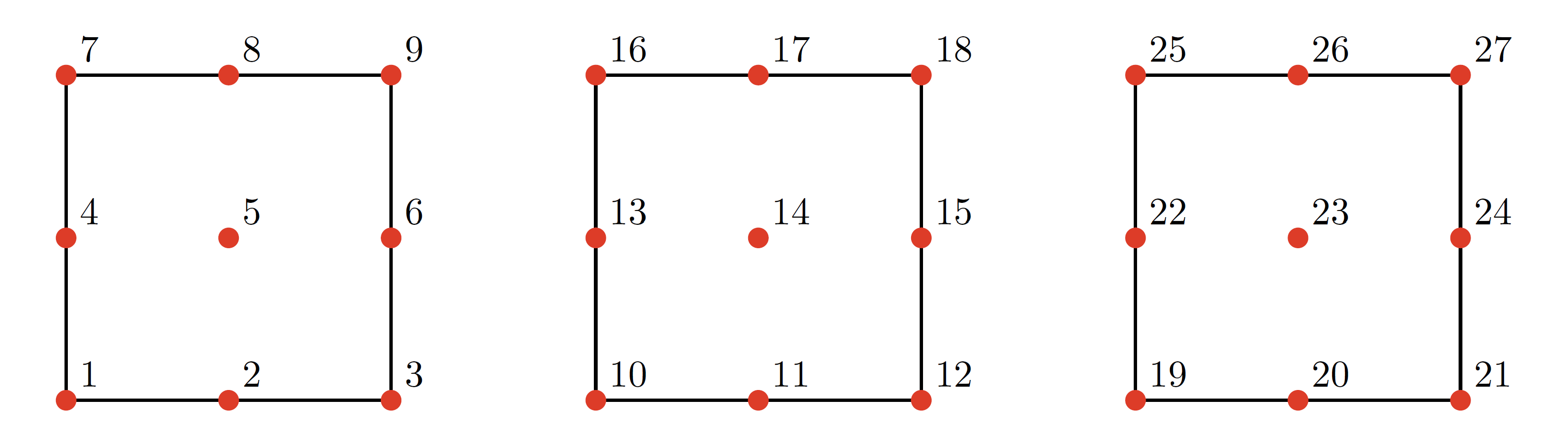

Figure 619: Node ordering for a BEX_HEX element with degree . From left to right, the figures show the nodes corresponding to slices at , , and , respectively.
Figure 620: Node ordering for a BEX_WEDGE element with degree . From left to right, the figures show the nodes corresponding to slices at at , , and , respectively.
Figure 621: Node ordering for a BEX_TETRA element with degree . From left to right, the figures show the nodes corresponding to slices at at at , , and , respectively.
Figure 622: Node ordering for a BEX_HEX element with degree . From left to right, the figures show the nodes corresponding to slices at at at , , and , respectively.

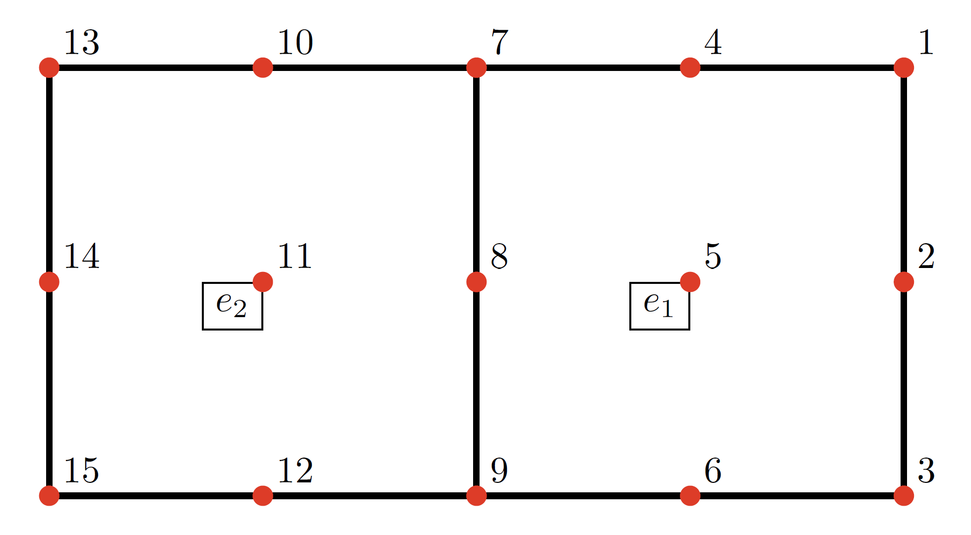

15.3.2.4.1.1 Bézier mesh with two elements
In this first example, we save a simple Bézier mesh as an Exodus file. The mesh is a simple rectangle composed of two biquadratic elements, and the interelement continuity is one. Using Coreform Cubit, the Exodus file can be generated with the following commands:
Example journal file that creates a simple U-spline and exports the Bézier mesh Exodus format
reset reset iga create surf rect width 2 height 1 move surf 1 x 1 y 0.5 surf 1 size 1 mesh surf 1 uspline surf 1 export uspline 1 exodus ’two_elem_example’
The resulting Bézier mesh is shown in figure 623.
The tables below show the expected output data contained in the Exodus file.
Figure 623: Schematic of the simple U-spline surface created by the Coreform Cubit commands shown above. The surface is composed of two biquadratic Bézier elements, and , with continuity between elements. The global control points are shown in red.
Attribute or variable name
Value
xcoord
{2.0, 2.0, 2.0, 1.5, 1.5, 1.5, 1.0, 1.0, 1.0, 0.5, 0.5, 0.5, 0.0, 0.0, 0.0}
ycoord
{1.0, 0.5, 0.0, 1.0, 0.5, 0.0, 1.0, 0.5, 0.0, 1.0, 0.5, 0.0, 1.0, 0.5, 0.0}
zcoord
{0.0, 0.0, 0.0, 0.0, 0.0, 0.0, 0.0, 0.0, 0.0, 0.0, 0.0, 0.0, 0.0, 0.0, 0.0}
bex_weight
{1.0, 1.0, 1.0, 1.0, 1.0, 1.0, 1.0, 1.0, 1.0, 1.0, 1.0, 1.0, 1.0, 1.0, 1.0}
Value
elem_type
BEX_QUAD
num_elem_blk
2
num_nodes_per_elem
9
bex_elem_degrees
{ 2, 2 }
connect
1, 2, 3, 4, 5, 6, 7, 8, 9 7, 8, 9, 10, 11, 12, 13, 14, 15

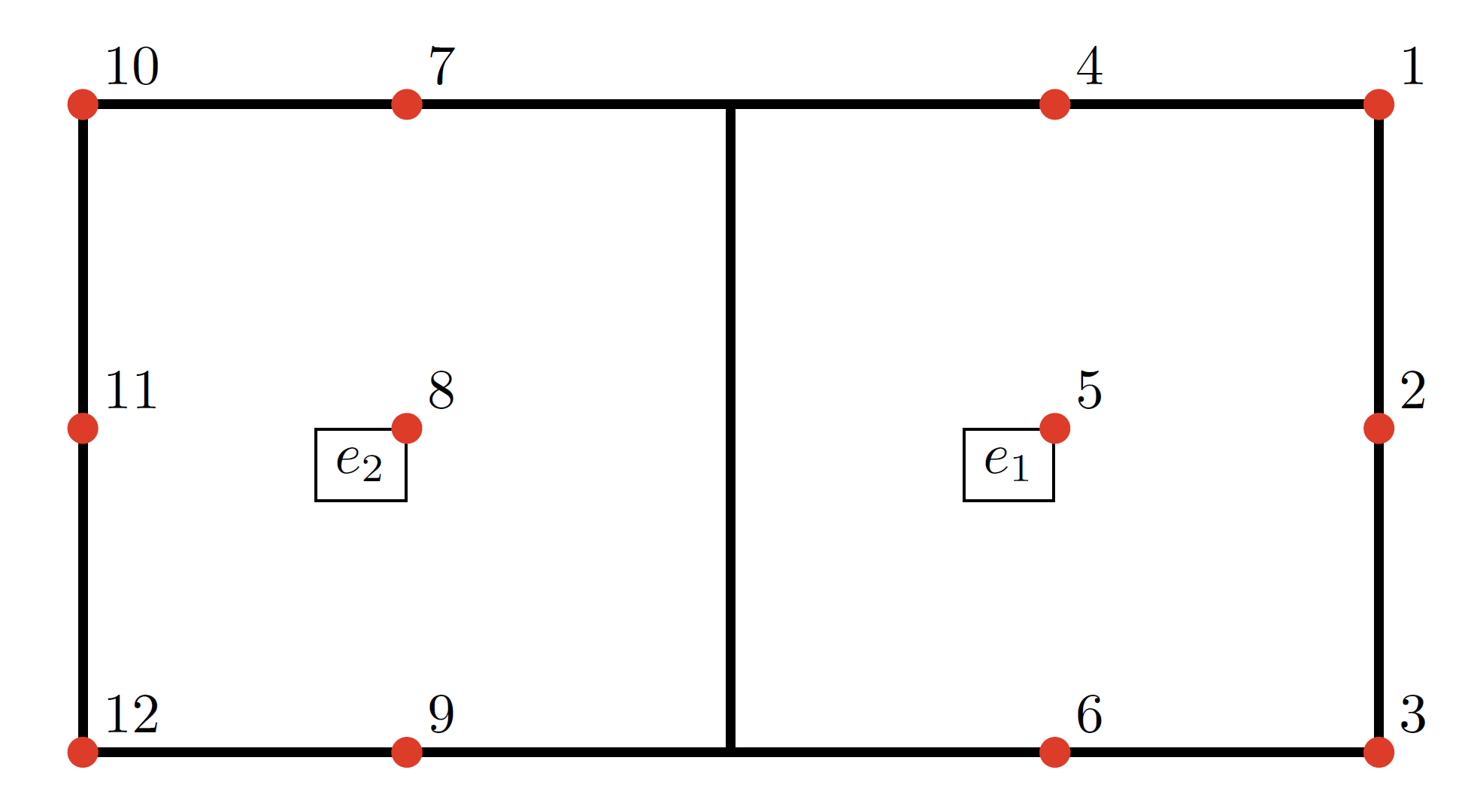

15.3.2.4.1.2 Spline mesh with two elements
In the previous example, the extraction operator was applied to the spline mesh before writing down the data to the Exodus file, so the Bézier mesh was saved into the Exodus file. In the present example, we save the spline mesh and its extraction operators directly to the Exodus file.
To generate the file, we change the last line of the Coreform Cubit command shown above in Bézier mesh with two elements by
export uspline 1 exodus ‘two_elem_example’
The resulting U-spline surface is shown in figure 624.
Figure 624: Schematic of the simple U-spline surface created by the Coreform Cubit commands shown above. The surface is composed of two biquadratic Bézier elements, and , with continuity between elements. The global control points are shown in red.
Value
xcoord
{ 2.0, 2.0, 2.0, 1.5, 1.5, 1.5, 0.5, 0.5, 0.5, 0.0, 0.0, 0.0 }
ycoord
1.0, 0.5, 0.0, 1.0, 0.5, 0.0, 1.0, 0.5, 0.0, 1.0, 0.5, 0.0 }

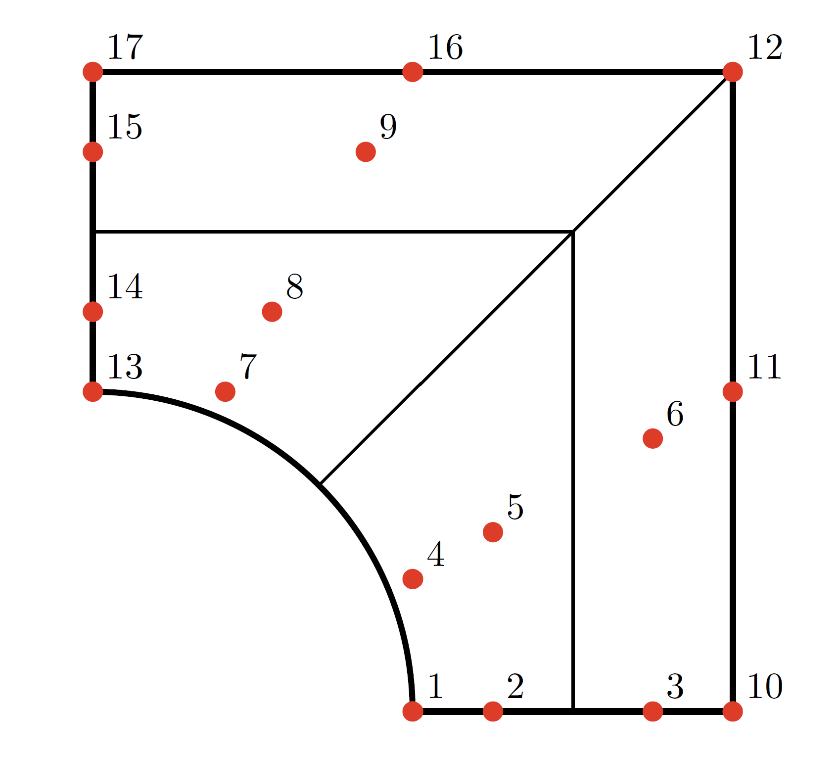

15.3.2.4.1.3 Rational spline mesh with four elements
This example shows just the data entries for a four element mesh of a quarter section of a plate with a hole.
Figure 625: Quarter segment of a plate with a hole.
Value
xcoord
{1,1.25,1.75,0.92388,1.25,1.75,0.382684,0.56066,0.853553,2,2,2,0,0,0,1,0}
ycoord
{0,0,0,0.382684,0.56066,0.853553,0.92388,1.25,1.75,0,1,2,1,1.25,1.75,2,2}
zcoord
{0,0,0,0,0,0,0,0,0,0,0,0,0,0,0,0,0 }
bex_weight
{ 1, 1, 1, 0.92388, 1, 1, 0.92388, 1, 1, 1, 1, 1, 1, 1, 1, 1, 1 }
Value
elem_type
BEX_QUAD
num_elem_blk
4
num_nodes_per_elem
18
bex_elem_degrees
{ 2, 2 }
connect
{ 1, 2, 3, 4, 5, 6, 7, 8, 9, 31, 23, 19, 16, 13, 11, 8, 4, 1, 2, 3, 5, 6, 8, 9, 10, 11, 12, 28, 30, 14, 15, 6, 7, 20, 12, 3, 4, 5, 6, 7, 8, 9, 13, 14, 15, 28, 21, 17, 29, 22, 18, 10, 5, 2, 5, 6, 8, 9, 12, 14, 15, 16, 17, 24, 26, 25, 27, 20, 8, 9, 12, 3 }
Value
bex_dense_cv_info
{31, 9}
bex_dense_cv_blocks
{ 0.00, 0.00, 0.00, 0.00, 0.00, 0.00, 0.00, 0.00, 0.25 0.00, 0.00, 0.00, 0.00, 0.00, 0.00, 0.00, 0.00, 0.50 0.00, 0.00, 0.00, 0.00, 0.00, 0.00, 0.00, 0.00, 1.00 0.00, 0.00, 0.00, 0.00, 0.00, 0.00, 0.00, 0.50, 0.25 0.00, 0.00, 0.00, 0.00, 0.00, 0.00, 0.00, 1.00, 0.50 0.00, 0.00, 0.00, 0.00, 0.00, 0.00, 0.25, 0.00, 0.00 0.00, 0.00, 0.00, 0.00, 0.00, 0.00, 0.25, 0.50, 0.00 0.00, 0.00, 0.00, 0.00, 0.00, 0.00, 0.50, 0.00, 0.00 0.00, 0.00, 0.00, 0.00, 0.00, 0.00, 0.50, 1.00, 0.00 0.00, 0.00, 0.00, 0.00, 0.00, 0.00, 1.00, 0.00, 0.00 0.00, 0.00, 0.00, 0.00, 0.00, 0.50, 0.00, 0.00, 0.25 0.00, 0.00, 0.00, 0.00, 0.00, 1.00, 0.00, 0.00, 0.00 0.00, 0.00, 0.00, 0.00, 1.00, 0.50, 0.00, 0.50, 0.25 0.00, 0.00, 0.00, 0.50, 0.00, 0.00, 0.25, 0.00, 0.00 0.00, 0.00, 0.00, 0.50, 1.00, 0.00, 0.25, 0.50, 0.00 0.00, 0.00, 0.00, 1.00, 0.00, 0.00, 0.50, 0.00, 0.00 0.00, 0.00, 0.25, 0.00, 0.00, 0.00, 0.00, 0.00, 0.00 0.00, 0.00, 0.25, 0.00, 0.00, 0.50, 0.00, 0.00, 0.00 0.00, 0.00, 0.50, 0.00, 0.00, 0.00, 0.00, 0.00, 0.00 0.00, 0.00, 1.00, 0.00, 0.00, 0.00, 0.00, 0.00, 0.00 0.00, 0.50, 0.25, 0.00, 0.00, 0.00, 0.00, 0.00, 0.00 0.00, 0.50, 0.25, 0.00, 1.00, 0.50, 0.00, 0.00, 0.00 0.00, 1.00, 0.50, 0.00, 0.00, 0.00, 0.00, 0.00, 0.00 0.25, 0.00, 0.00, 0.00, 0.00, 0.00, 0.00, 0.00, 0.00 0.25, 0.00, 0.00, 0.50, 0.00, 0.00, 0.00, 0.00, 0.00 0.25, 0.50, 0.00, 0.00, 0.00, 0.00, 0.00, 0.00, 0.00 0.25, 0.50, 0.00, 0.50, 1.00, 0.00, 0.00, 0.00, 0.00 0.50, 0.00, 0.00, 0.00, 0.00, 0.00, 0.00, 0.00, 0.00 0.50, 0.00, 0.00, 1.00, 0.00, 0.00, 0.00, 0.00, 0.00 0.50, 1.00, 0.00, 0.00, 0.00, 0.00, 0.00, 0.00, 0.00 1.00, 0.00, 0.00, 0.00, 0.00, 0.00, 0.00, 0.00, 0.00 }
