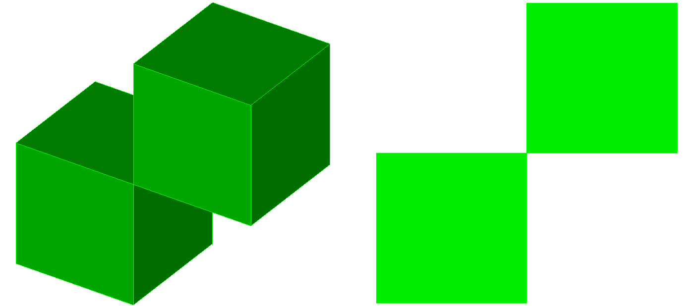

Cubit does not currently support building U-splines on non-manifold meshes. This includes edges that are shared by more than two elements for surface splines, as shown in figure 469. It also includes elements that are connected only by vertices for surface splines, or by edges or vertices for volumetric splines, as shown in figure 470.

Figure 470: Examples of non-manifold meshes where elements are connected only by d-2-cells.
