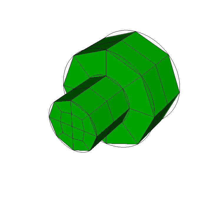

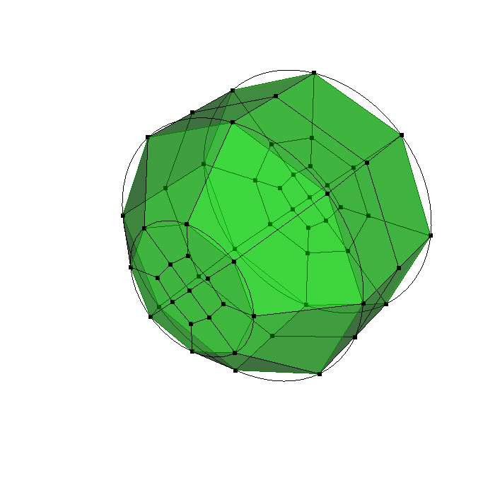

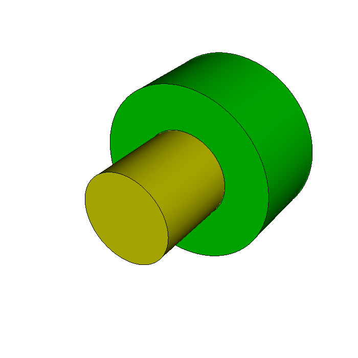

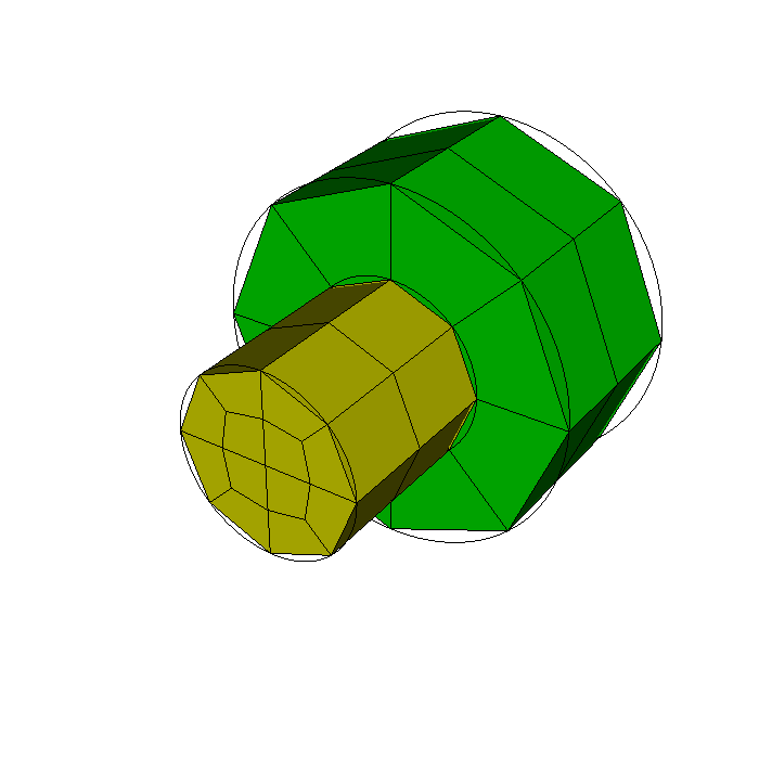

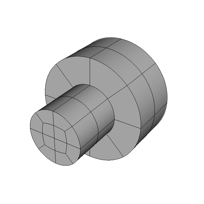

As an example, consider the two cylinders created using the following commands:
create cylinder height 2 radius 2 create cylinder height 2 radius 1 move vol 1 z 1 move vol 2 z 3 imprint vol all merge vol all vol all size 1 surf 2 5 6 scheme circle surf 7 scheme hole vol all scheme sweep mesh vol all uspline vol all
This sequence of commands results in the U-spline volume shown in the third image of figure 471 (top right, in grayscale).
By contrast, U-spline construction fails if the two cylinders are joined into a single volume before meshing, as shown in the fourth image (bottom left) of figure 471. Cubit can generate a swept mesh in this case also, as seen in the fifth image, but only via a many-to-one sweep involving non-contiguous source surfaces. Attempting to build a U-spline on the resulting mesh will fail with the error
ERROR: Cannot build volumetric splines over Volume 1 which is a many to one sweep with non-contiguous source surfaces.
Figure 471: This figure shows the restrictions on building U-spline volumes over many-to-one swept meshes. (a) A CAD geometry decomposed into two volumes. (b) The mesh of the two volume CAD geometry. Each volume is meshed as a one-to-one sweep. (c) The resulting U-spline volume. (d) The same CAD geometry represented as a single volume. (e) The mesh of the single volume CAD geometry. The volume is meshed using a many-to-one sweep. Because the two source surfaces are not contiguous, a U-spline volume cannot be built on this mesh.

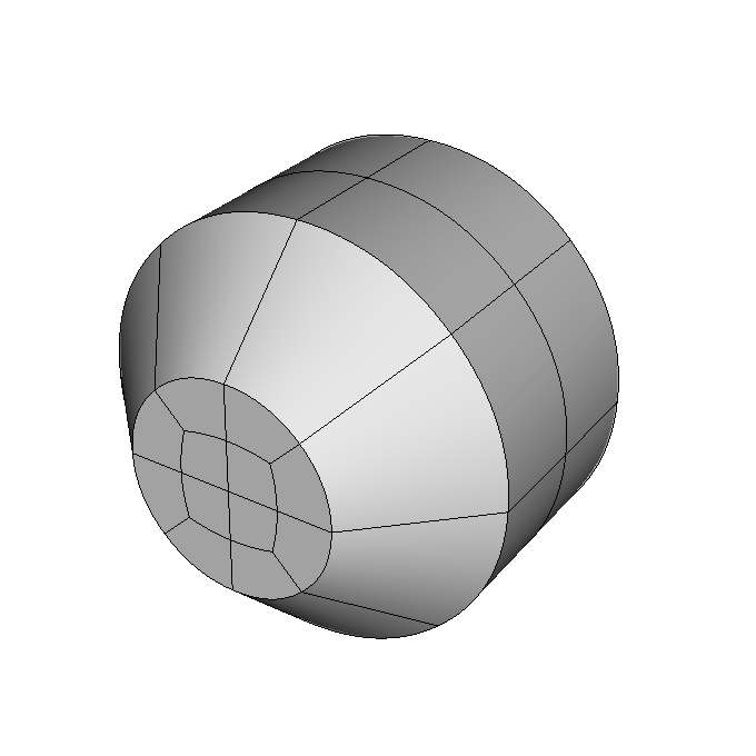

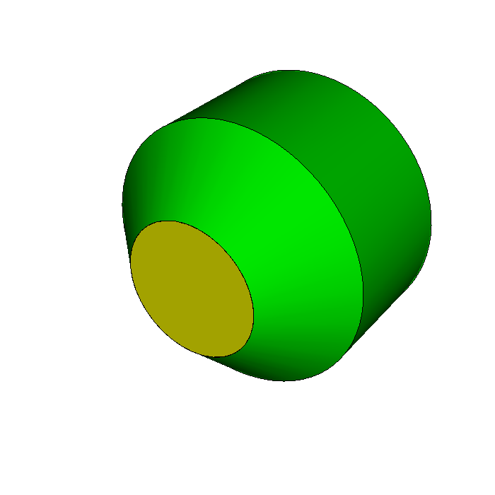

create Cylinder height 2 radius 2 move vol 1 z 1 create frustum height 2 radius 2 top 0 webcut volume 2 with plane zplane offset 0 delete Volume 2 compress all move vol 2 z 3 unite body 1 2 webcut volume 1 with cylinder radius 1 axis z compress all imprint vol all merge vol all surf 2 size .5 vol 1 size 1.5 surf 2 scheme circle volume 2 scheme Sweep source surface 2 target surface 7 sweep transform translate propagate bias volume 1 scheme Sweep source surface 3 target surface 5 sweep transform least squares mesh vol 2 mesh vol 1 uspline vol all

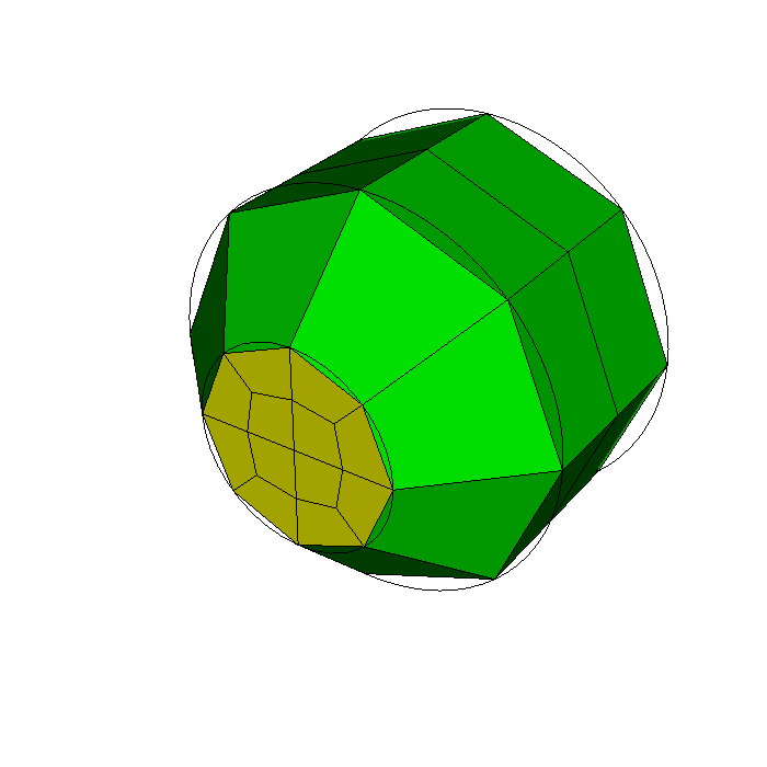

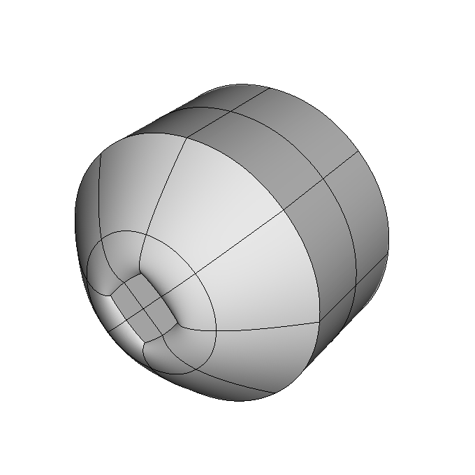

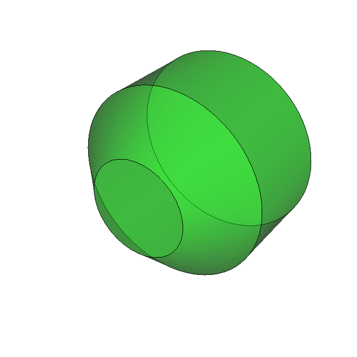

The geometry, mesh, and resulting U-spline volume generate by the commands are shown in the first three images of figure 472. If we instead build a U-spline over the single volume shown in fourth image (lower left), the algorithm succeeds, but issues the warning
WARNING: Some edges which are at surface kinks in the CAD are not creased in the spline.
As the last image of figure 472 shows, the resulting U-spline volume fails to accurately capture a key feature of the original geometry.
Figure 472: This figure shows the workflow for ensuring sharp features are preserved in a U-spline volume fitted to a CAD geometry. (a) A CAD geometry decomposed into two volumes, separated by a sharp feature in the geometry. (b) The mesh of the two-volume CAD geometry. (c) The resulting U-spline volume, which accurately captures the sharp edge between the two volumes. (d) The same CAD geometry represented as a single volume. (e) The mesh of the single volume CAD geometry. (f) The resulting U-spline volume. Note that the sharp corner is not preserved in this U-spline volume.
