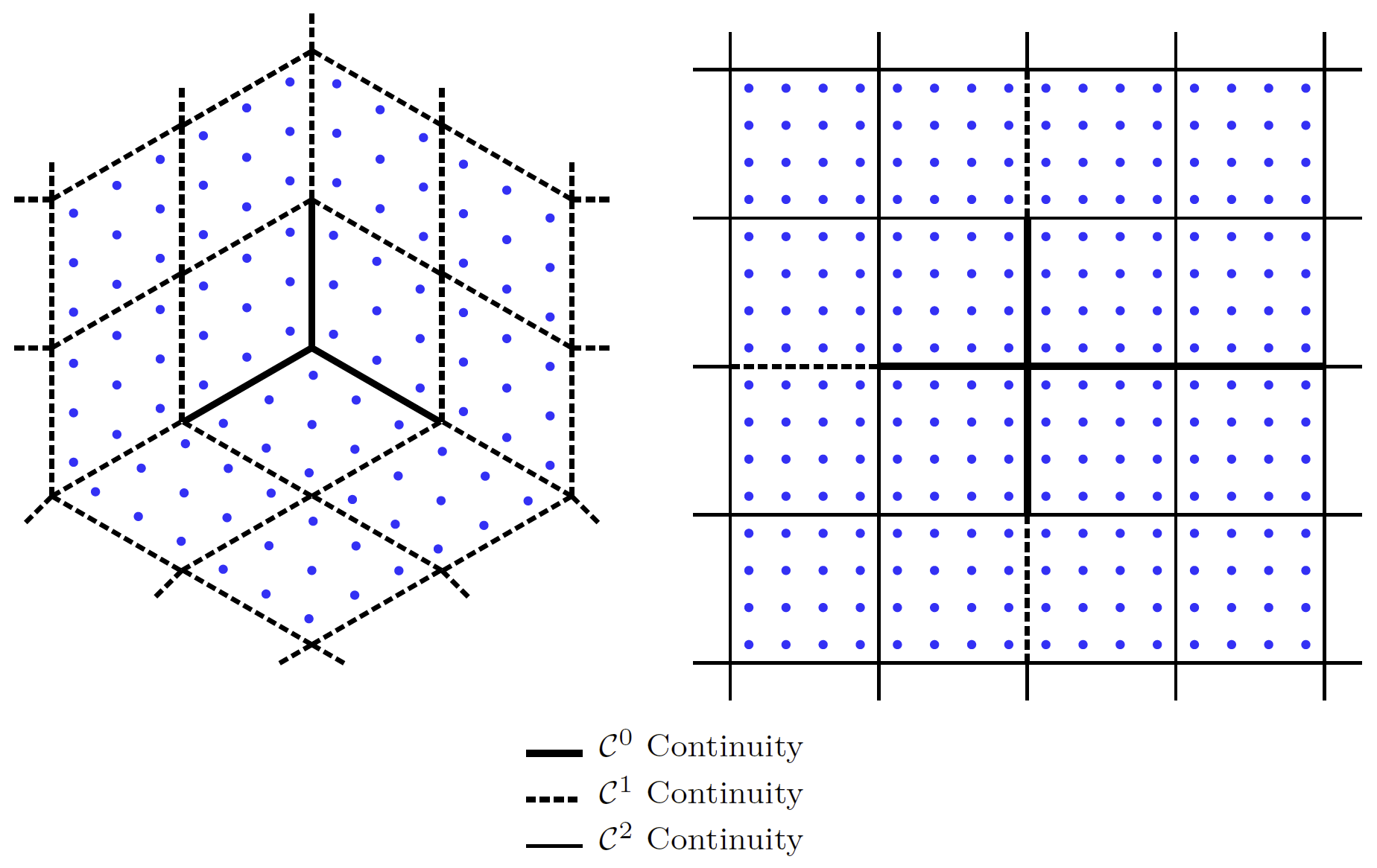

Two examples of meshes with continuity grading near creased vertices are seen in figure 473 .
Figure 473: Two admissible meshes with creased vertices. The continuities of the edges on the lines emanating from the creased vertices are graded such that an edge n bays away from the creased vertex is assigned a continuity less than or equal to .

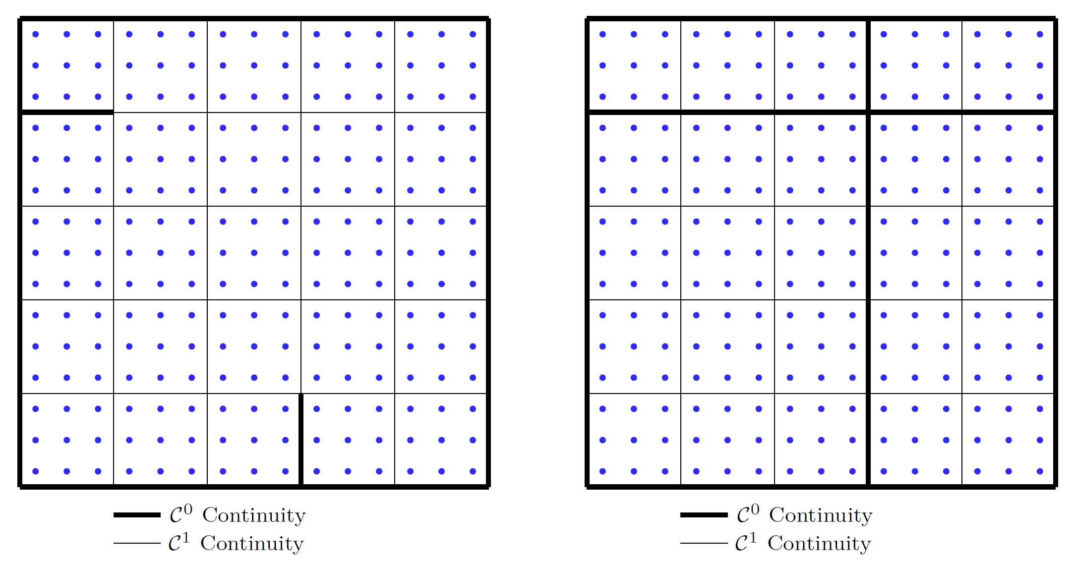

6.3.3 Maintaining distance between perpendicular continuity transitions
Continuity transitions along perpendicular edge lines are required to maintain a sufficient distance from each other, as dictated by the degree and continuity on the mesh.
This distance is measured by drawing a line called a ray from the continuity transition in the direction of lower continuity. The length of a ray is determined by the degree and continuity on the mesh near the ray. On a mesh with a maximum continuity of , the length of the ray will not exceed the prescribed degree p on the mesh (but may be shorter if a creased edge is encountered) .
The rays emanating from two perpendicular continuity transitions may not meet or intersect except when the intersection is tail-to-tail or head-to-tail. An algorithm in Coreform Cubit will analyze the input mesh and detect any pair of continuity transitions that have intersecting rays. The algorithm will then crease edges near these continuity transtions to shift the transition locations away from each other to resolve the issue.
An example of automatic creasing to avoid crossing continuity transition rays is seen in figure 474 .
Figure 474: The mesh on the left is not admissible because two perpendicular continuity transitions are close enough that their rays intersect (in this case, they meet head-to-head which is disallowed). On the right, two additional edges are creased in the mesh so that the rays now meet tail-to-tail, forming an admissible mesh configuration.

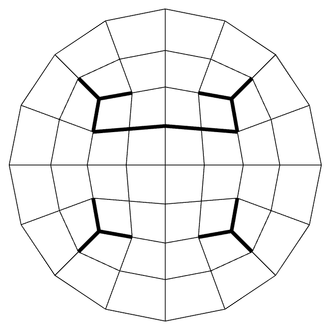

6.3.5 Automatic minimal creasing example on a Cubit mesh

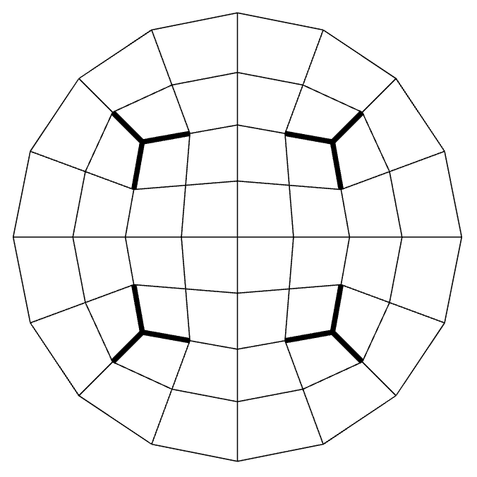

To see automatic creasing at work on a relatable example, observe the mesh shown on the left in figure 476. All cells in this mesh are quadratic p = 2, and all edges were initially set to a continuity of .
On the right, the thicker black lines indicate the default minimal creasing that will be automatically performed around the mesh’s four extraordinary vertices in order to render it admissible.
Figure 476: An example Cubit mesh. The cells are quadratic (p = 2), and all edges are initially set to continuity. All extraordinary vertices are always automatically creased to .

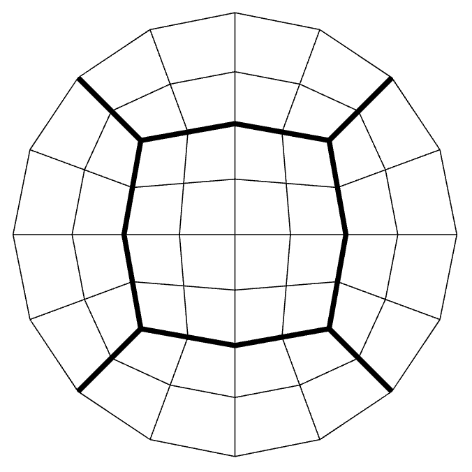

6.3.6 Automatic full creasing on a Cubit mesh

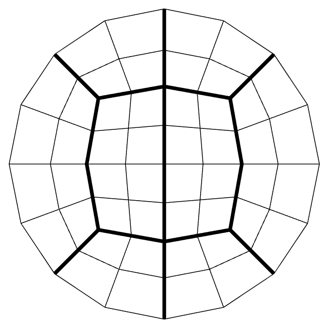

If the option creasing is set to full, then continuity transitions are disallowed in the mesh, requiring all edge-lines to have the same continuity.
Figure 477 depicts the further automatic creasing performed when creasing is changed from the default minimum to full. This option creases not only the twelve edges that touch an extraordinary vertex, but also every edge-line that adjoins a creased edge.
Figure 477: If the option creasing is set to full, we see that all edge-lines originating at the extraordinary vertices will be automatically creased to remove all continuity transitions from the mesh.

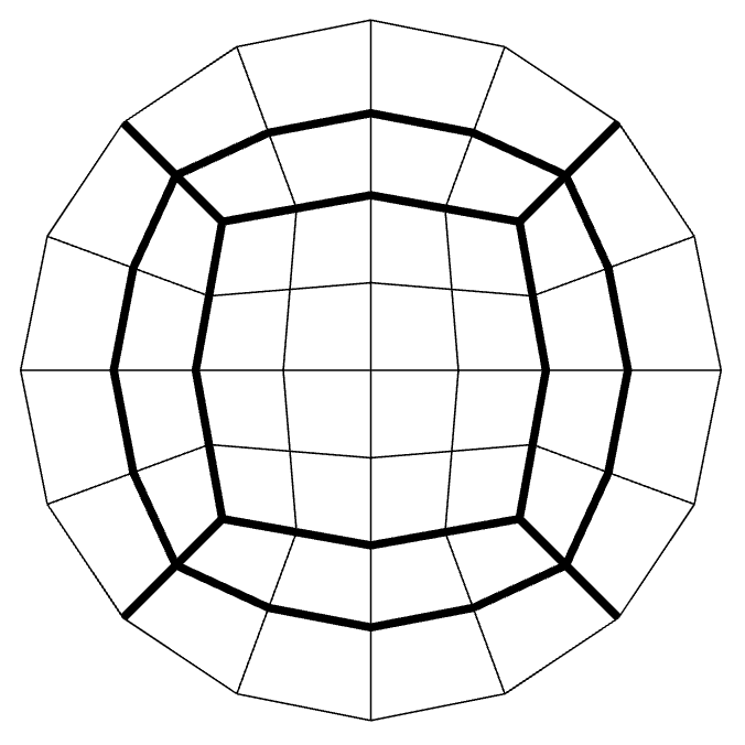

The creasing full procedure described above applies not only to the default creasing required for admissibility, but also to any additional, user-specified creasing. That is, if a user causes additional edges to be creased, the creasing full option will automatically crease all edge-lines adjoining these user-creased edges as well.

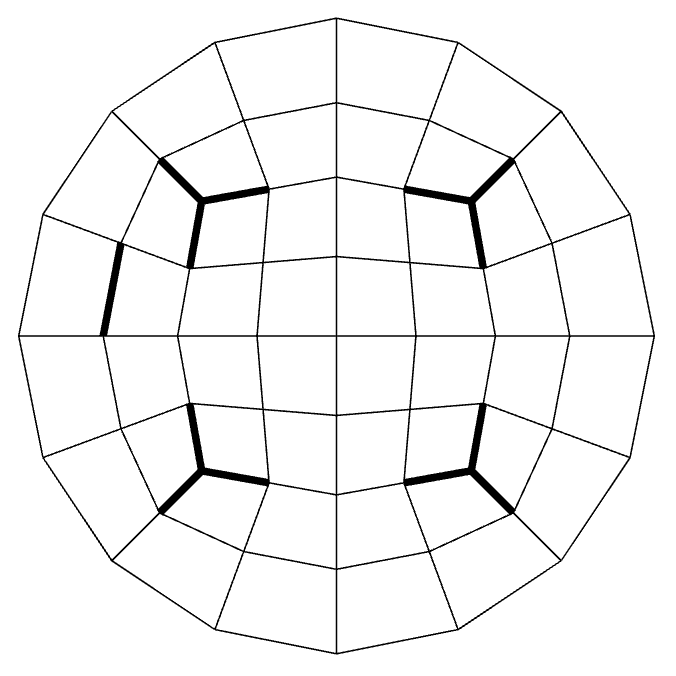

The results of full creasing are shown in figure 478. The meshes on the left each feature one user-specified creased edge beyond the minimal default required around extraodinary points.
The images on the right show the subsequent, additional creasing automatically performed when the creasing full option is selected and the creasing of all edge-lines adjoining creased edges is enforced.
6.3.8 Automatic minimial creasing with user-specified creased edges
Figure 478: Examples of automatic creasing when the option creasing is set to full in cases where extra edges were initially creased by the user. On the left are the meshes prior to enforcing the creasing option, and on the right are the meshes after the extra edges are automatically creased.

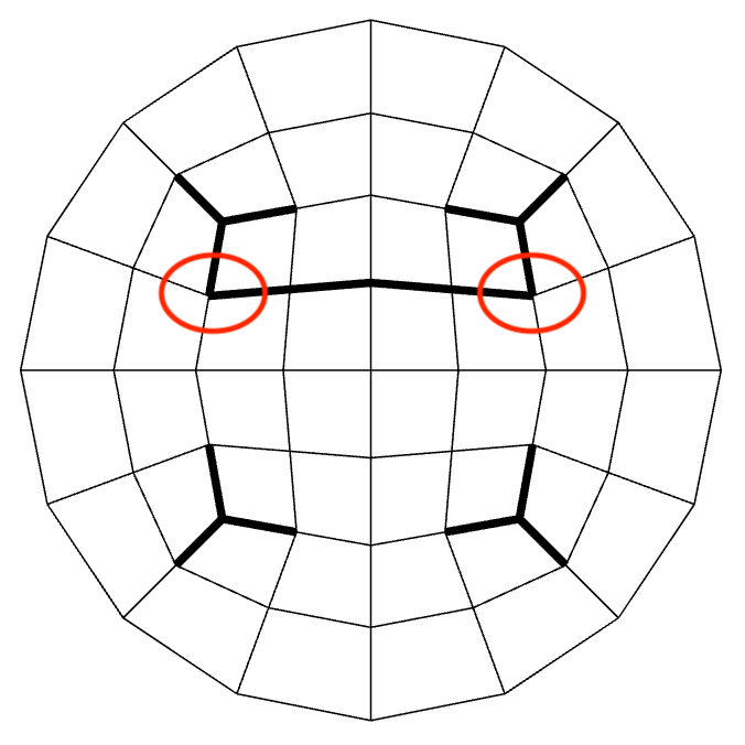

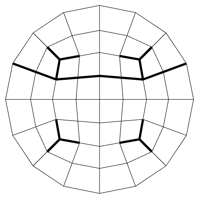

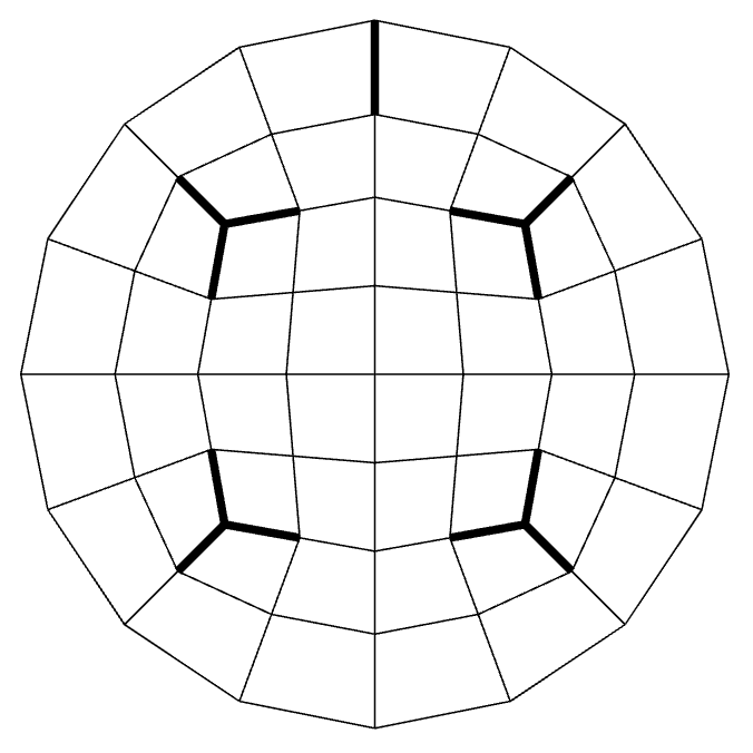

Finally, figure 479 shows a case where user-specified creasing results in additional automatic creasing when the creasing option is set to minimal.
In the center image, the circled vertices show where the user-creased edges has resulted in perpendicular continuity transition rays that are intersecting in a way that is not admissible, as explained above in Maintaining distance between perpendicular continuity transitions. The image to the right shows one possible way the minimal automatic creasing algorithms may resolve this problem.
Figure 479: An example of automatic creasing when the option creasing is set to minimal and the user has specified additional edges to be creased in a way that resulted in an inadmissible configuration. On the left we see the mesh after the extraordinary vertices are creased and the extra edges specified by the user are creased. In the middle the vertices where admissibility violations are occuring (due to intersecting continuity transition rays) are circled. On the right we see one possible resolution to the issue, resulting in an admissible mesh.
