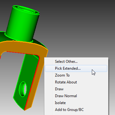

3.5.4.1 Accessing the Dialog
The dialog is accessible any time a geometry entity is selected in the graphics window. Consider this workflow:
3.5.4.1.1 Launch the Dialog
Figure 80:

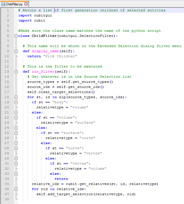

3.5.4.3.1 A Simple Example Filter
This first example shows a filter that will return a list of first generation children of the selected entities. No user input is required and no additional user interface is necessary.
Figure 88:
  • The filter’s File Name and Class Name must match. In this example, the file name is ChildFilter.py and the class name is "ChildFilter".
  • LINE 2: import cubitgui – this is the Python module that owns the base class (SelectionFilter) from which this filter class is derived.
  • LINE 3: import cubit – this is the Python module that grants access to all of the CubitInterface functions.
  • LINE 6: When defining the class do the following:
    • Ensure the class name matches the file name
    • Derive the class from cubitgui.SelectionFilter
  • LINE 9: Implement the ’virtual’ function "display_name". Return a string that represents the name of the filter. It is this name that will be shown in the Extended Selection dialog’s filter menu.
  • LINE 13: Implement the ’virtual’ function "run_filter. This is the actual filter.
  • LINE 15: The function get_source_types() returns a list of the types selected in the "Source Selection" list of the Extended Selection dialog.
  • LINE 16: The function get_source_ids() returns a list of the ids selected in the "Source Selection" list of the Extended Selection dialog.
  • LINE 17: The function clear_target_selections() clears the Target Entities list of the Extended Selection dialog.
  • LINE 18: The example filter begins manipulating data to suit its needs
  • LINE 35: The function get_relatives(...) is a member of CubitInterface. It returns a list of ids of a specified type
  • LINE 37: The function add_target_selection(<type> <id>) adds one instance of an entity-type/id to the Target Entities list.

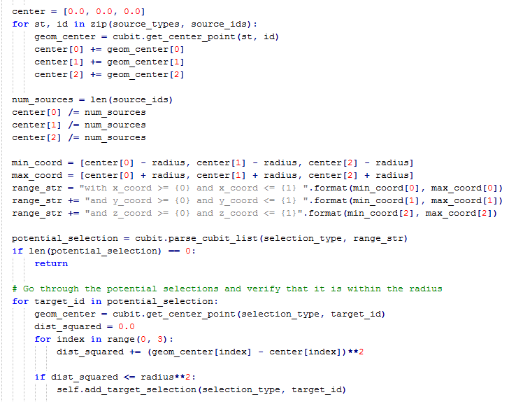

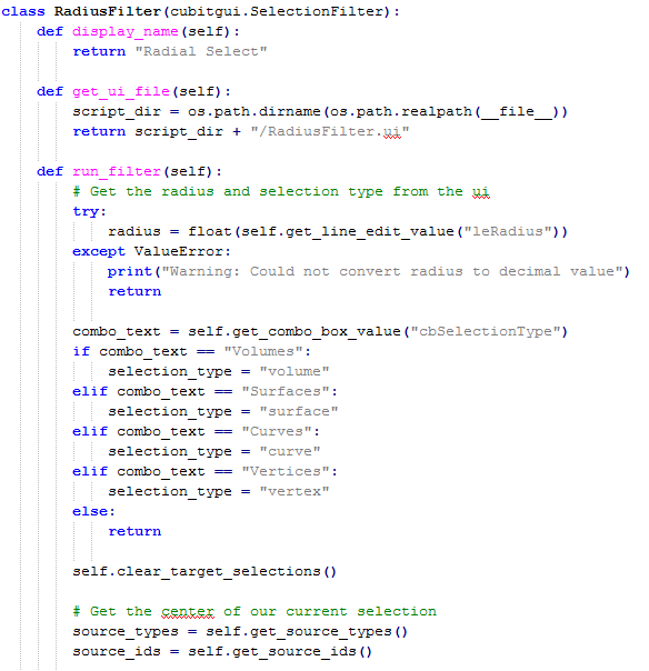

3.5.4.3.3 A Sample Filter that Includes Additional User Interface
In order to include user input into an extended selection dialog, two additional things must happen:
1) The developer must create the user interface definition file (.ui file) using Qt Designer;
2) An additional function must be implemented in the class definition of the Python filter. The additional function is called get_ui_file().
Qt UI objects supported by the extended selection filter include:
1) QLineEdit - std::string get_line_edit_value ( object-name )
2) QComboBox - std::string get_combo_box_value( object-name )
3) QRadioButton - bool get_radio_button_value( object-name )
4) QCheckBox - bool get_check_box_value(object-name )
5) QSpinBox - int get_spin_box_value(object-name )
6) QSlider - int get_slider_value(object-name )
As the example Python code shows, the Qt objects are referenced by name. These code snippets below are not complete. Complete examples and a video tutorial are available from http://www.coreform.com. Detailed training is also available upon request.
