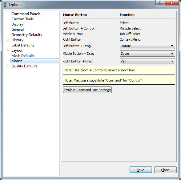

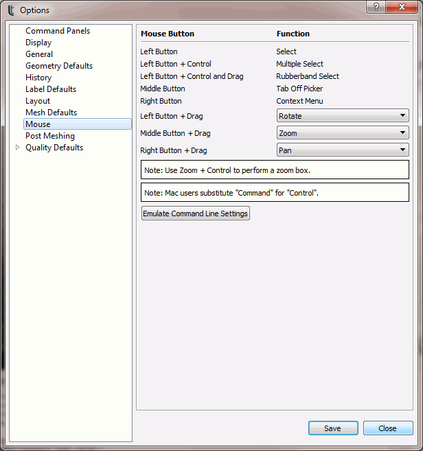

3.4.2 Mouse Based View Navigation: Zoom, Pan and Rotate
The mouse can be used to navigate through the scene using various view transformations. These transformations are accomplished by clicking a mouse button in the graphics window and dragging, sometimes while holding a modifier key such as Shift or Control. When run with graphics on, Cubit is always in mouse mode; that is, mouse-based transformations are always available, without needing to enter a Cubit command. Mouse-based view transformations are accomplished by placing the pointer in the graphics window and then either holding down a mouse button and dragging, or by clicking on a location in the graphics window. Some functions also require one or more modifier keys to be held down; the modifier keys used in Cubit are Shift and Control
Each of the available view transformations has a default binding to a mouse button-modifier key combination. This binding can be changed by the user if desired. Transformations and button mappings are summarized in the following table.
These settings are applicable only to the UNIX command line version of Cubit. For a description of the Graphical User Interface Mouse Operations see GUI View Navigation.
The bindings are based on the following mouse button definitions:
Figure 63:
Figure 1. Default Mouse Function Mappings for the Command Line
Table 1. Mouse Function Bindings for Zoom, Pan, and Rotate
Function
Description
Binding
Rotate
Rotates the scene about the camera axis. Dragging the mouse near the center of the graphics window will rotate the camera’s X- or Y-axis; dragging near the edge of the window will rotate about the Z-axis (i.e. about the camera’s line of sight). Type a u in the graphics window to see the dividing line between the two types of rotation.
B1
Zoom
Zooms the scene in or out by clicking the mouse in the graphics window and dragging up or down. If the mouse has a wheel, the wheel will also zoom.
B2
Pan
"Drags" the scene around with the mouse
B3
Navigational Zoom
Zooms the scene by moving both the camera and its focal point forward.
shift_key.gif B2
Telephoto Zoom
Zooms the scene by decreasing the field of view.
shift_key.gif control_key.gif B2
Pan Cursor
Click on new center of view
shift_key.gif B3
3.4.2.1 Changing the View Transformation Button Bindings
The default mapping of functions to mouse buttons, described in the Default Mouse Function Mappings table above, can be modified. There are two ways to assign a function to a button/modifier combination. First, you can use the command
Mouse Function <function_id> Button <1|2|3> [Shift][Control]
Type help mouse function to see a list of function IDs that may be used in this command. Second, you can assign functions interactively. To do so, first put the pointer into a graphics window and then hit the F key. On-screen instructions will lead you through the rest of the process. The GUI Options panel for managing the mouse bindings can be found at Tools/Options/Mouse, and is as follows:

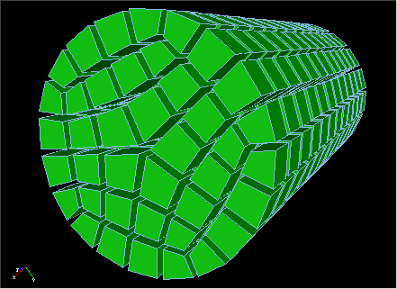

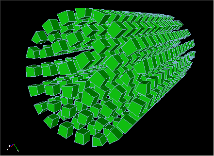

3.4.4.1 Displaying Using the Element Facets
There is another option that is similar to a graphics mode, set with the command
graphics use facets [on|off]
This command determines how shaded and filled surfaces are drawn when they are meshed. If Graphics Use Facets is on, the mesh facets (element faces) are used to render the model. This is particularly helpful for curved surfaces which may cut through some of the mesh faces. A comparison of graphics facets on and off is shown below.
Figure 66: A meshed cylinder shown with graphics facets off (left) and graphics facets on (right); note how geometry facets on the curved surface obscure mesh edges when facets are off.

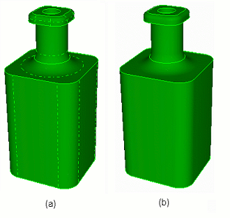

3.4.4.2 Displaying Composite Surface Lines
Composite surfaces are surfaces that have been joined together using virtual geometry. By default, the underlying surfaces are marked with dashed lines. To toggle this setting so that underlying surfaces are not shown, use the following command:
graphics composite {on|off}
Figure 67: A part shown with (a) composite surfaces displayed (b) composite surfaces not displayed

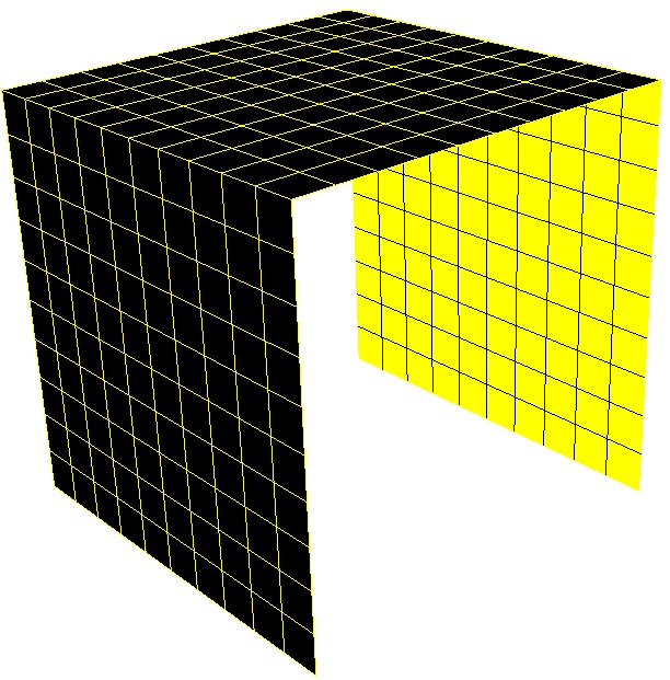

3.4.5.1.1 Displaying Entity Orientation
The normal to one or more surfaces, mesh faces, or mesh triangles may be drawn with the command
draw {surface | face | Tri} <id_range> normal [Length <length>] [face | tri] color <color> [add]
Surface normal command colors the surfaces using two different colors. The surface exposed to the positive half space (i.e, along the direction of normal), will always be colored black. The surace exposed to the negative half space will be colored using the specified <color>.
If the Face or Tri qualifier is included in the Draw Normal command, the normals for all faces or tris that belong to the specified surface are drawn.
Arrow representing the normal will be displayed if "Length" is specified.

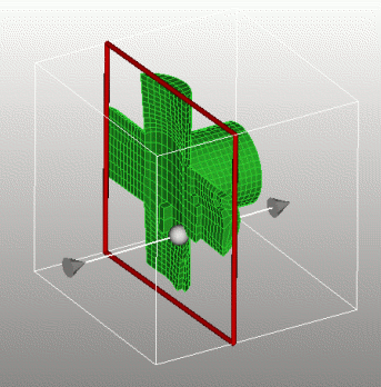

3.4.6 Graphics Clipping Plane
The graphics clipping plane feature allows the user to temporarily cut parts of the model away to help visualize the interior of a geometry or mesh. The command syntax is:
graphics clip {on|off} [ plane <plane> | [location <location>] [direction <direction>]]
graphics clip manipulation {on|off}
The GUI tool bar buttons to enable and manipulate the Graphics Clipping Plane are shown below:
Figure 70:

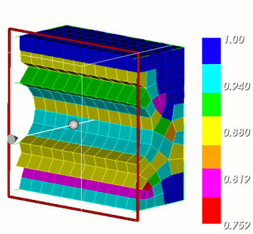

The first command activates the graphics clip manipulation tools in the graphics window. The keyboard shortcut "Shift-S" while the graphics window is active will also activate the clipping plane. The manipulation of the clipping plane is controlled as follows:
Figure 71: Graphics Clipping Plane
The second command turns on/off the visibility of manipulation widget in the graphics window. The clipping plane is still active, but the controls are hidden. The normal mouse-based view navigation controls apply.
3.4.6.1 Examples
brick x 10 sphere rad 1 graphics clip on location -2 0 0 rotate -45 about y #shows the sphere inside the brick
brick x 10 cylinder rad 2 z 12 subtract 2 from 1 mesh vol 1 quality vol 1 draw mesh graphics clip on #shows the mesh quality on interior elements
Figure 72: Viewing mesh quality of interior elements

A volume mesh can be viewed one layer at a time using a visualization tool known as mesh slicing. This tool divides the elements of one or more volumes into axis-aligned layers, and then allows the mesh to be displayed one layer at a time. Mesh slicing is especially useful to view the quality of swept meshes that are axis aligned.
3.4.14.1 Notes on Mesh Slicing
Mesh slicing is only intended to be a rough visualization tool. Because the average mesh edge length is used to determine the thickness of each layer, a layer may be more than one element deep. Unstructured meshes, meshes with large variations in edge length, and non-axis-aligned meshes will be more difficult to visualize with this tool.
3.4.14.2 Mesh Slicing Command
Mesh slicing can be started either by entering a keypress in the graphics window, which slices the mesh of the entire model, or by entering the command
Graphics Slice {Body | Volume} <id_range> Axis {X | Y | Z}
which slices only the bodies or volumes indicated, with a plane along the axis specified.
Key presses in the graphics window which control mesh slicing are summarized in the following table.
Key
Action
X,Y or Z
Initiate mesh slicing using the X, Y or Z plane
K
Move the slicing plane in the positive coordinate direction
J
Move the slicing plane in the negative coordinate direction
S
Toggles drawing single or multiple slice layers in the view
Q
Exit from mesh slicing mode
See Graphics Clipping Plane for instructions on clipping the graphics using the GUI clipping plane.

3.4.15.1 Silhouette Lines
Some shapes, such as cylinders, are drawn with silhouette lines; these lines don’t represent true geometric curves, but help visualize the shape of a surface. Silhouette lines can be turned on or off with the command
Graphics Silhouette [On|Off]
The pattern used to draw silhouette lines can be set using the command
Graphics Silhouette Pattern [Solid | Dashdot | Dashed | Dotted | Dash_2dot | Dash_3dot | Long_dash | Phantom]

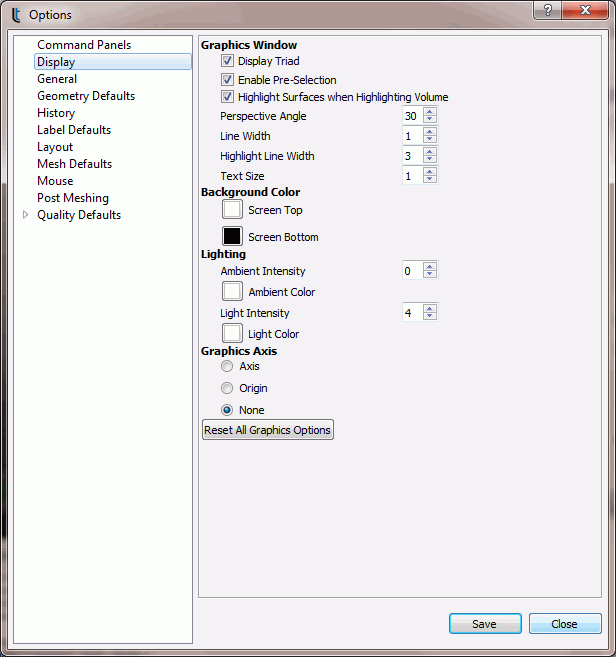

By default, an axis appears in the corner of the graphics window. This corner axis, also called the triad, can be disabled or re-enabled with the command
Graphics Triad [On | Off]

3.4.15.11 Shrink
The shrink graphics attribute allows you to view the elements shrunken about their centroid. This is useful for viewing 3D meshes, permitting viewing of interior elements. It may also be useful for visually inspecting the mesh for missing elements. To use the shrink option use:
graphics shrink <value>
draw hex <range>
draw tet <range>
where value is a number between 0 and 1. One (1) will shrink the elements to a point, while zero (0) will not shrink the elements. The following figures illustrate the effect of element shrink on a hex mesh.
Figure 77: Top: shrink=0.2, Bottom: shrink=0.5
3.4.15.12 Facet Tolerance
The graphics tolerance commands change the way that facets are drawn in the graphics window. It does not affect the underlying geometry, just the graphics display. It can be useful to change the facet tolerance on large models if the refresh speed is slow.
graphics tolerance [ [ANGLE|distance] <val>|default ]
Specifying an angle will change the maximum allowable angle between neighboring facets. The distance option will set a maximum distance between adjacent facets. Increasing either of these numbers will result in coarser facets. The default option will return values to their default settings.
The GUI Options panel for manipulating these settings is found under Tools/Options and is shown below:
Figure 78:
