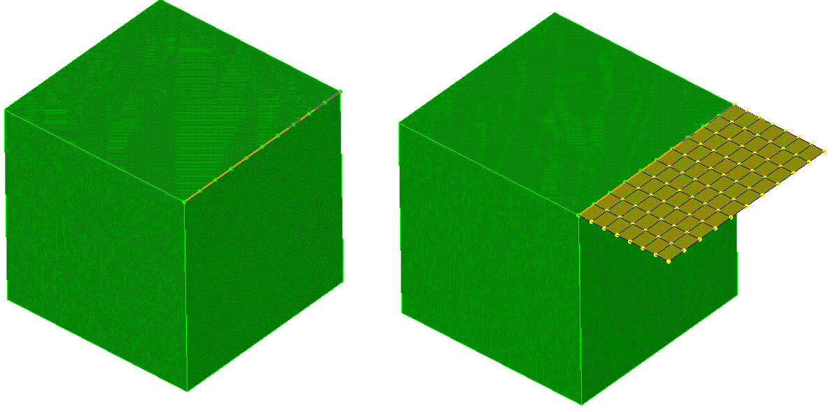

Figure 113: Surface extruded along -X direction without 'include_mesh' option.

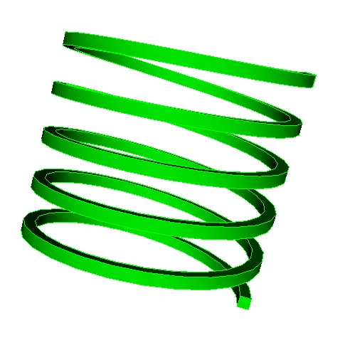

4.2.1.1.14 Sweep Surface along Helix
Sweep a surface along a helix, where the helix is defined by an axis, thread_distance (distance between turns in axis direction), axis, and handedness (right_handed or left_handed.
To sweep a Surface or Curve along a Helix
  1. On the Command Panel, click Geometry.
  2. To sweep a surface, click on Volume. To sweep a curve, click on Surface.
  3. Click on the Create action button.
  4. Select Sweep from the drop-down menu.
  5. Enter in the desired Surface or Curve ID(s). This can also be done using the Pick Widget function.
  6. Select Helix from the Sweep Method menu.
  7. Click the appriapte Axis from the Axis of Rotation menu.
  8. Enter in the appropriate values for Helix Height and Rotation Angle.
  9. Enter in any other desired settings
  10. Click Apply.
Sweep {Surface|Curve} <id_range> Helix {axis <xpoint ypoint zpoint xvector yvector zvector> | xaxis | yaxis | zaxis} thread_distance <val> angle <val> [RIGHT_HANDED|left_handed] [anchor_entity] [include_mesh] [keep] [merge]
Specifying multiple Surfaces that belong to the same Body can cause the creation of invalid Bodies and is discouraged.
axis = axis about which to create the sweep
thread_distance = distance between each 360 degree segment of the helix
angle = number of degrees in rotation of the helix
handedness = right-handed or left- handed threads

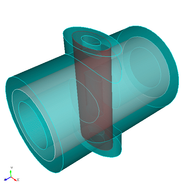

Figure 114: Helical Sweep

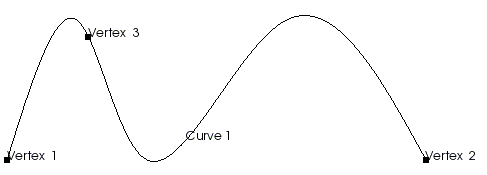

4.2.1.2.3 Spline
The spline form of the command creates a spline curve that passes through all specified vertices or locations. The syntax is shown below:
Create Curve Spline {List of locations} [delete]
The delete option will remove all of the intermediate vertices used to create the spline leaving only the end vertices.
See Location, Direction, and Axis Specification to view the location specification syntax.
4.2.1.2.4 Example
create curve spline vertex 1 to 10
An alternate form of the command can be used with only vertex ids using the syntax below and is retained for backwards compatibility.
Create Curve [Vertex] <start_vertex> <end_vertex> <interior_vertex_ids> [Spline] [Delete]

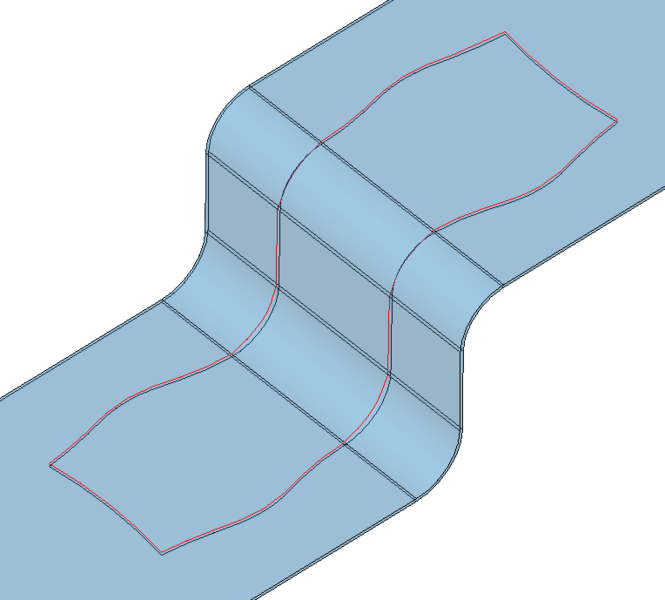

The project command projects curves, or the curves of a surface another a single surface or multiple surfaces of a volume or body. The command syntax is as follows:}
Project {Curve <id_list> | Surface <id_list } Onto Surface <surface_id> [Imprint [Keepcurve] [Keepbody]] [Trim]
Project { Curve <id_list> | Surface <id_list> Onto {Body <id> | Volume <id>} [Target_surface <id_list>] [Imprint [Keepcurve] [Keepbody]]}
The first form of the command takes a list of curves or surfaces, and a projection surface. If a list of curves is given, the result will be the creation of a set of free curves on top of the projection surface. If a list of surfaces is given, the result will be the same as selecting the curves of the surface (i.e. a group of free curves on the projecting surface).
The second form will imprint the list of curves (or curves of the surface(s)) onto the surfaces of the specified bodies or volumes. The Target_surface option helps when the projection is ambiguous, for example projecting curves onto a thin-walled volume where the projection could be to either side, as shown in Figure 117.
Figure 117: Example of projecting curves to specific side of thin-walled volume

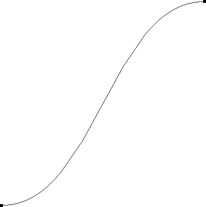

This command will create a spline curve by specifying the end points and the tangents at those points. The command syntax is as follows:
create curve tangent vertex <id> [direction (options)] vertex <id> [direction (options)]
create curve tangent location (options) direction (options) location (options) direction (options)
Both forms of the command can be broken into two parts: the starting point and ending point of the curve. The tangent direction is grouped with the associated point.
The first form of the command takes an existing vertex and an optional tangent direction. If the direction is not specified, it will be taken from the tangent at the endpoint of the connected curve. If the vertex is not connected to a curve, or it is connected to multiple curves, the direction must be specified. If the vertex is not connected to a curve, it will be incorporated into the new curve. Otherwise, a new vertex will be created for the new curve.
The second form of the command takes a location and a tangent direction. The directions must be specified and vertices will be created for the locations.
The two command forms can also be mixed. A curve can be created from an existing vertex and a specified location.

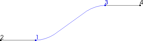

4.2.1.2.19 Examples
create curve tangent location 0 0 0 direction 1 0 0 location 1 1 0 direction 1 0 0
Figure 118: Create tangent curve with locations and tangent directions
create curve tangent vertex 1 vertex 3
merge vertex all
Figure 119: Create tangent curve by specifying vertices on curves. Tangents are extracted from the curve at the vertex location.

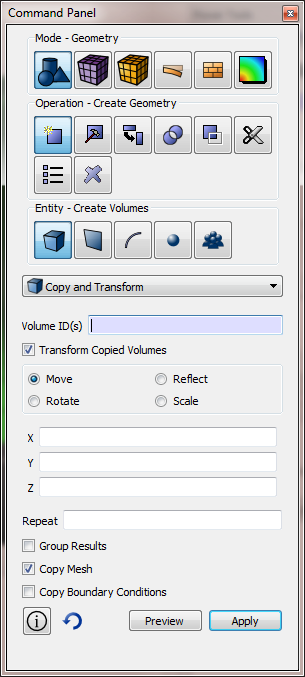

  5. Click on Transform Copied Surfaces and select Move, Rotate, Reflect or Scale.
  6. Enter in the appropriate settings.
  7. Click Apply.
Create Surface From Surface <surface_id>

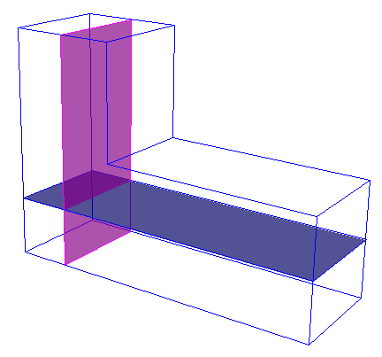

4.2.1.3.10 Midsurface
Multisurfaces may be created midway between pairs of surfaces using the following command:
To create a Surface midway between pairs
  1. On the Command Panel, click on Geometry and then Surface.
  2. Click on the Create action button.
  3. Select Midsurface from the drop-down menu.
  4. Enter the appropriate values for Volume ID and Surface ID Pairs. This can also be done using the Pick Widget function.
  5. Click Apply.
Create Midsurface {Body|Volume} <id> Surface <id11> <id12> ... <idN1> <idN2>
where N denotes the number of pairs of surfaces. An even number of surfaces must be specified, and the command will group them by pairs in the order in which they are provided. The resulting surface will be trimmed by the specified body or volume <id>. This replaces the create midplane command in previous versions of Cubit.
Figure 122: Multisurface created with the Create Midsurface command
Figure 123: Midsurface created from 2 pairs of cylindrical surfaces
Midsufaces can also be extracted without surface pair specification if the resulting surface is a single sheet of surfaces (no T intersections).
For automatic midsurface extraction
  3. Select Auto Midsurface from the drop-down menu.
  4. Enter the appropriate values for Volume ID(s). This can also be done using the Pick Widget function.
  5. Enter the appropriate values for Lower Bounds and Upper Bounds.
  6. Enter in any other appropriate settings from this menu.
Create Midsurface {Body|Volume} <id_range> Auto [Delete] [Transparent] [Thickness] [Limit <lower_bound> <upper_bound>] [Preview]
Figure 124 shows a simple auto midsurface example. The command for the example is:
create midsurface volume 1 auto delete
Figure 124: Midsurface created from a volume

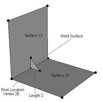

4.2.1.3.11 Weld Profile
Surfaces may be created by specifying a weld profile using the following command:
Create Surface Weld [Root] Location {options} Weld Surface <id_list> Length <val> [<val2>]
Weld surfaces can be used to create a simulated welded joint by sweeping the surface along the root curve and uniting the new body to the model. An example of the command is illustrated below. For a detailed description of the location specifier see Location Direction, and Axis Specification.
create surface weld root location vertex 25 weld surface 13 14 length 2
Figure 125: Weld Profile surface with length and root specifications

Vertex 3 in the following example was created with this command:
create vertex on curve 1 fraction 0.25 from vertex 1
Figure 127: Create Vertex a Fraction of the length of a Curve

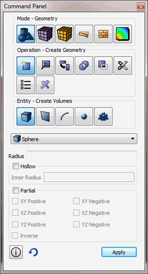

4.2.2.8 Creating Spheres
Figure 134:
The sphere command generates a simple sphere, or, optionally, a portion of a sphere or an annular sphere.
To create a Sphere
  1. On the Command Panel, click on Geometry and then Volume.
  3. Select Sphere from the drop-down menu.
  4. Enter the desired value for the Radius.
  5. Fill out any other desired values or options on the menu.
  6. Click Apply.
[Create] Sphere Radius <radius> [Xpositive]|[Xnegative] [Ypositive]|[Ynegative] [Zpositive]|[Znegative] [Delete] [Inner [Radius] <radius>]
