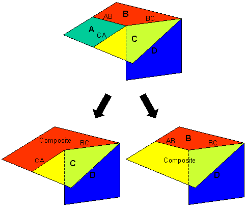

The composite create surface command is non-deterministic in some circumstances. When three or more adjacent surfaces are to be composited, all the surfaces may not be able to be composited into a single surface as illustrated in Figure 204. In this case different subsets of the surfaces may be composited and the command will choose arbitrary subsets to composite. As an example, there are three surfaces A, B, and C, all adjacent to each other. The common curve between A and B is AB, the common curve between B and C is BC, and the common curve between A and C is CA. If the curve BC cannot be removed, either due to the angle specified in the composite command, or because there is a fourth surface, D, also using that curve, the command will arbitrarily choose to either composite A and B or A and C.
Figure 204: In some cases, the program will make a determination of which surfaces to composite.

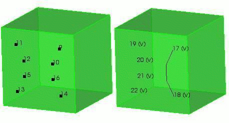

In the following simple example, the surface is partitioned using both methods. On the left half of the object, the surface is partitioned using the individual option (vertices 11 12 15 13). On the right half, a polyline is used (vertices 9 10 16 14). All of the free vertices can then be deleted, leaving the virtual curves shown in the second picture. Vertices 19 20 21 and 22 are all zero-length curves. The small ’v’ in parentheses is to indicate that it is virtual geometry. The resulting mesh is shown in the third picture. Notice that the polyline constrains the entire curve to the mesh, while the hardpoints constrain only that individual point.
Figure 205: Partitioning a Surface Using Vertices

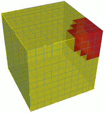

4.8.3.3 Partitioned Volumes
To partition a volume by giving a center and radius:
Partition Create Volume <id> Center [Location] {options} Radius <val>
This command splits the existing volume into two volumes. All volume elements that lie within the specified radius of the specified center location are identified, and the exterior faces of these elements are used to create a surface and partition the volume. The center can be specified with any of the location options.
Figure 206 shows an example of a partitioned volume. A cube that has been map meshed is partitioned using a center at one of its vertices. The result is two distinct volumes with a surface separating the two. The interface surface is composed of the faces of the interior hex elements.
Figure 206: A partitioned volume
This command may be useful for separating small regions of a meshed volume so that remeshing or mesh improvement may be performed locally.

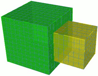

The following is a trivial example of this capability. The following commands create two meshed blocks:
brick width 10
brick width 6
body 2 move x 8
volume 1 2 size 1
mesh volume 1 2
Figure 207 shows the results of these commands.
Figure 207: Two adjacent meshed volumes. The coincident meshes will form the basis of the imprint operation.

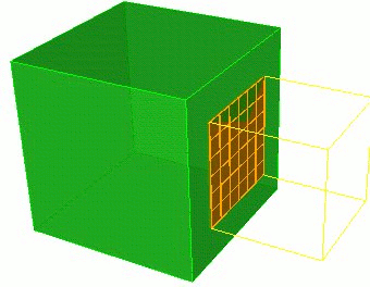

The mesh of the blocks can be joined by first doing a mesh-based imprint and then merging:
imprint mesh body 1 2
merge body 1 2
Figure 208. shows the results of the imprint operation. A meshed surface is created at the interface between the two meshed volumes. The nodes on the new surface are shared by the neighboring hexahedra of both volumes.
Figure 208: The imprinted surface. Adjacent volume meshes joined at the interface surface.

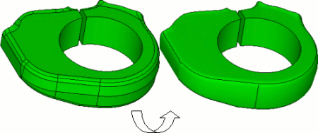

4.8.5 Simplify Geometry
Simplifying topology by compositing individually selected surfaces is often a tedious and time-consuming task. The simplify command addresses the tedium by automatically compositing surfaces and curves based on selected criteria between neighboring entities. Figure 209 shows a typical example of simplify command usage (’simplify volume 1 angle 15’).

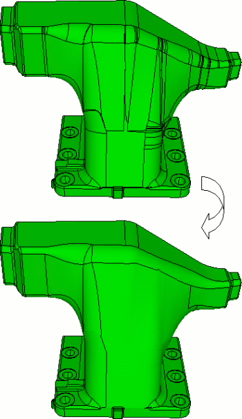

Figure 209: Typical Simplify command usage
The command syntax and discussion items are shown below.

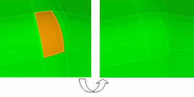

4.8.5.3 Respecting Vertices, Curves and Surfaces
Surfaces, curves, and vertices can be specified to prevent geometry features from automatically being composited. Figure 210 show an example of respecting a surface (’simplify vol 1 angle 15 respect surf 289’).
Figure 210: Respecting a surface
For complex geometries, it is often useful to preview the simplify command and then add any respected geometry to the command respect lists.

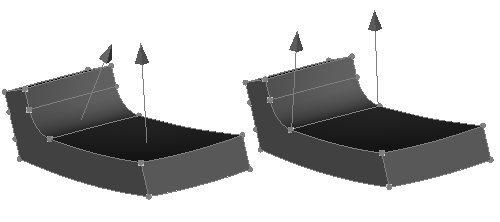

By default the command will compare the average normal of two adjacent surfaces to determine whether they should be composited. By issuing the local_normal option, the test will be modifed slightly. The modified test will compare the maximum difference between normals along the shared curve(s) for the two surfaces.
Figure 212: Comparison of surface normals using the average surface normal method (on the left) and local normal method (on the right).
