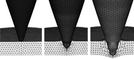

5.12.4.4.8 Apply Deformations
This option permits the user to import time-dependant deformation information from the Exodus file. For this option, any vector data in the Exodus II file is assumed to be deformation information. If selected, deformations will be applied to the nodes upon import. Enter a specific time step value, integer step, or the last time available in the file. If time-dependant data is available in the Exodus II file, selecting the down arrow in the edit field will display the available time steps in the file. Default time is the last time step.
Figure 467: Example of remeshing of a deformed finite element mesh
Figure 467 shows an example of using Mesh-Based Geometry for a large deformation analysis. In this case, the analysis [Attaway et. al.,98] began and continued until mesh quality became unacceptable. At that point, the mesh was imported into Cubit and geometry re-created from the computed deformations. The finite element mesh could then be removed, remeshed or improved and written back to an Exodus II file. After remapping [Wellman,99] the appropriate analysis variables back to the mesh, the analysis could then be restarted. This process was repeated multiple times until the desired results were achieved.
Note: Care should be taken when using large deformations, as inverted elements (negative Jacobians) may produce unpredictable results with the resulting geometric representation.
Also available is an optional scale factor. This applies the indicated scale to all deformations. Default is 1.0.

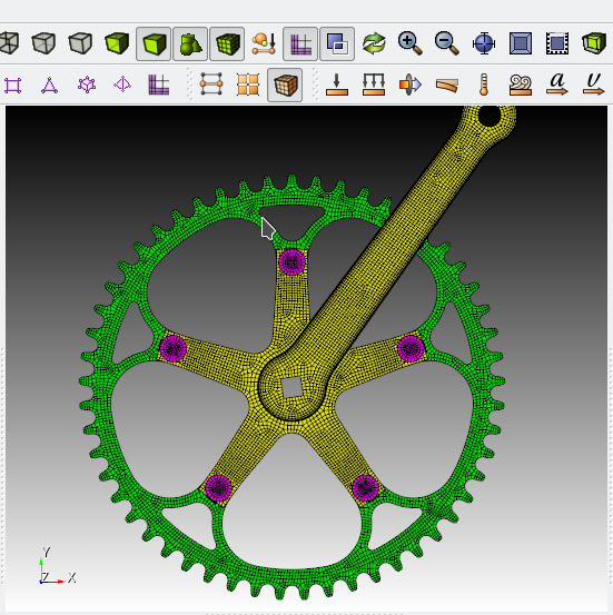

5.12.9.2 Graphics
Generally, the graphical features for lite meshes are supported at the same level as for heavy mesh. This includes the ability to draw, pick, and zoom, among other operations. The coloring of the mesh is based on blocks and may be adjusted by the user. Toggling visibility of all sidesets and nodesets can be done by clicking the Display Boundary Conditions toolbar button or with the bc visibility {on|off} command. Toggling visibility of all blocks can be done by clicking the Display Mesh toolbar button or with the mesh visibility {on|off} command.
Figure 468:
