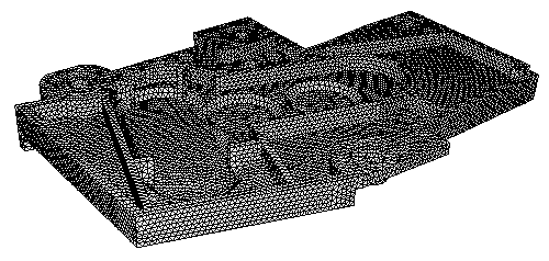

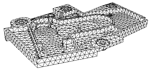

{geom_list} Size Auto [Factor <factor> ] [Individual] [Propagate]
Vertices are not valid in the geom_list for this command. Automatic interval size assignment works by examining the geometric characteristics of the entities in the geom_list and assigning a heuristic size to the entities and their child entities. The factor may be a floating point number between 1.0 and 10.0, where 1.0 represents a fine interval size and 10.0 represents a coarse size. The following image shows an example of different auto size specification on a CAD model.
Figure 220: auto size factor = 7.0
Figure 221: auto size factor = 5.0
Figure 222: auto size factor = 1.0

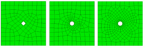

5.3.3.2 Maximum Spanning Angle on Arcs
On many CAD models, arcs or small holes require that a finer mesh be specified around these entities in order to maintain reasonable mesh quality. To facilitate this, the user may specify the maximum angle an element edge may span on an arc. To change or list the maximum arc span, use the following commands
set maximum arc_span <angle>
list maximum arc_span
The angle parameter must be a positive value less than 360. The maximum arc span setting will only be used if there is not already a user defined interval set on the arc, and if the interval setting produces mesh edges which exceed the maximum spanning angle. Figure 223 shows the effect of three different maximum arc_span settings on a small hole using the pave scheme.
Figure 223: Maximum arc_span settings of 90, 45 and 15 degrees respectively.

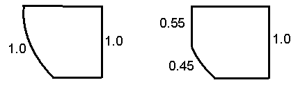

5.3.10 Relative Intervals
If the user needs fine control over mesh density, then for curvy or slanted sides of swept geometries, it is often useful to treat curves as if they had a different length when setting interval sizes. For example, the user may wish to specify that a slanting side curve and a straight side curve have the same "relative" length, despite their true length as shown in the following figure. These are not interval matching constraints; interval matching may change intervals so that the user-specified ratio does not hold exactly.
Figure 224:
The relative lengths of curves are set with the following command:
{geom_list} Relative Length <size>
The following command is used to assign intervals proportional to these lengths:
{geom_list} Relative Interval <base_interval>
For a curve with relative length x, setting a relative interval of y produces xy intervals, rounded to the nearest integer.

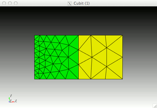

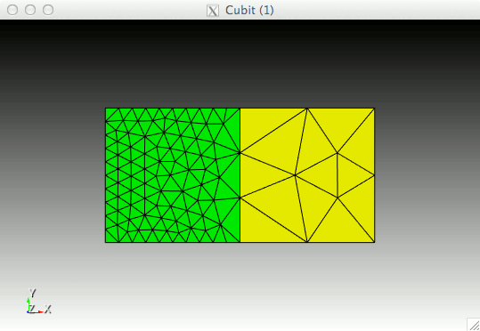

In the following examples, the surfaces have been given sizes. In the first graphic auto bias is not enabled. In the second graphic auto bias is enabled.
Figure 225:
Figure 226:
When auto bias is enabled sizes on vertices are respected.If a size hasn’t been directly set on a vertex the size is inherited from the parent(s).If there are multiple parents the inherited size is averaged.In the examples shown above the sizes of the vertices attached to both surfaces was an average of the two surface sizes.That affected the biasing while curve meshing.
