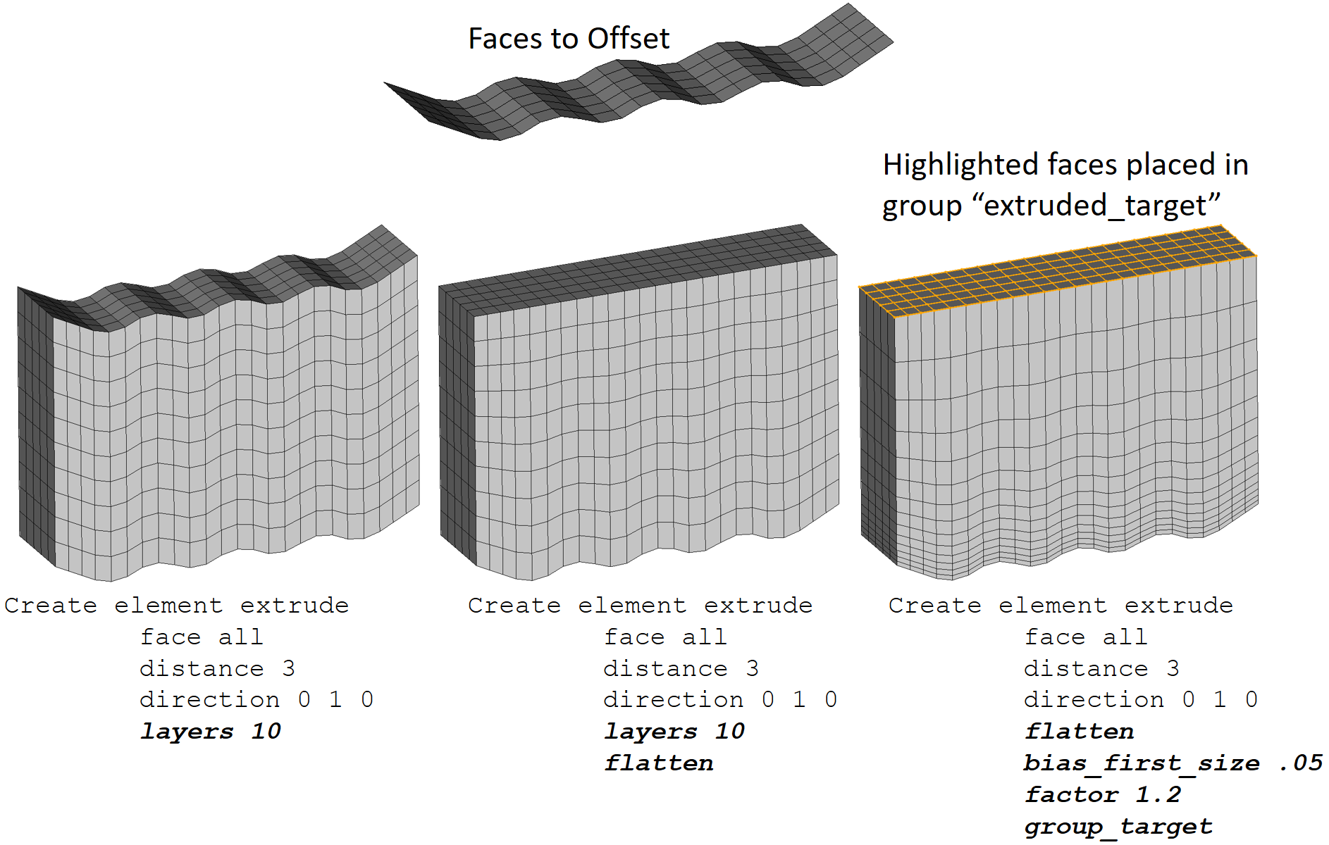

In the first form of the command, a direction and distance are specified to define the extrusion. To define node spacing along the extrusion, the command takes either the layers or bias_first_size and factor parameters, but not both. Specifying a value for the layers option determines how many evenly sized elements will be created in the given distance. The bias_first_size and factor parameters define a bias that will be used along the extrusion distance. When specifying entities to be extruded which are either non-planar, or not orthogonal to the extrusion direction, the flatten parameter results in the extrusion terminating on a single plane orthogonal to the extrusion direction. The optional group_target parameter places all of the faces, tris, edges, or nodes at the end of the extrusion into a group named "extruded_target" which can be conveniently used to define a subsequent extrusion with a different set of extrusion parameters. twist can also be specified and requires an angle of twist and a twist axis.
The figure below illustrates the new flatten, bias_first_size, factor, and group_target keywords. At the top is a set of non-planar faces to offset. On the bottom-left, each node on all of the faces are extruded the same amount resulting in a target of the extrusion with identical curvature to the input faces. In the bottom-middle, the flatten keyword is used, resulting in the extrusion terminating on a single plane. In the bottom-right, the bias_first_size, factor, and group_target keywords are used resulting in a biased extrusion, and the creation of a group named "extruded_target", which contains the faces on the end of the extrusion.
Figure 458:

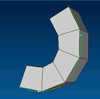

In the second form, a curve is specified, along with the input entities will be extruded. Extruding along a curve supports the layers parameter, but does not currently support the distance, bias_first_size, factor, flatten, twist or group_target parameters.
#Extrude a face in a given direction: create node location 0 0 0 create node location 1 0 0 create node location 1 1 0 create node location 0 1 0 create face node 1 to 4 create element extrude face 1 direction 0 0 1 distance 3 layers 3 create element extrude face 1 direction 0 0 1 distance 3 layers 3 twist 90 axis direction 0 0 1 origin 0 0 0 #Sweep face along curve
create node location 0 0 0 create node location 1 0 0 create node location 1 1 0 create node location 0 1 0 create face node 1 to 4 create vertex location position 0 0 0 create vertex location position 0 .2 1 create vertex location position 0 1 2 create vertex location position 0 3 2 create vertex location position 0 4 1 create vertex location position 0 5 0 create curve spline vertex 1 2 3 4 5 create element extrude face 1 layers 5 along curve 1
Figure 459: Extruding mesh elements along a spline

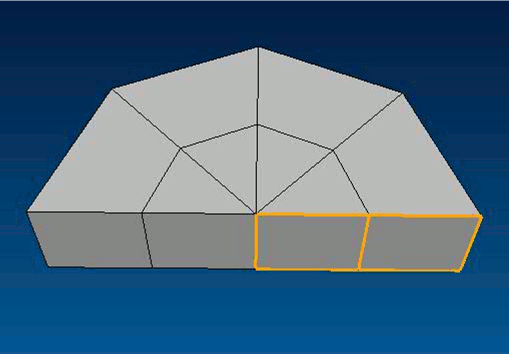

5.10.4.3 Revolving Mesh Elements
Elements can be created by revolving an existing element around a given axis. The attempt_fix parameter will try to fix any poorly formed hex elements by collapsing them into wedge elements. angle determines the amount of rotation around the axis. The layers option determines how many elements will be created in the given rotation. Elements can be organized into a block by specifying an optional block id. Higher order elements can be created by specifying the optional Element Type of the block.
Create Element Revolve {Edge|Face|Tri} <element_list> Axis <axis_options> Angle <angle> [Layers <num_layers>] [Block <id> [ element type {sphere|bar|bar2|bar3|beam|beam2|beam3|truss|truss2|truss3|spring|tri|tri3|tri6|tri7|trishell|trishell3|trishell6|trishell7|shell|shell4|shell8|shell9|quad|quad4|quad5|quad8|quad9|tetra|tetra4|tetra8| tetra10|tetra14|tetra15|pyramid|pyramid5|pyramid8|pyramid13|pyramid18|hex|hex8|hex9|hex20|hex27|hexshell| wedge|wedge6|wedge15|wedge16|wedge20|wedge21} [Attempt_fix]
#Revolve 2 faces around the Y-axis and collapse inner hexes to wedges create node location 0 0 0 create node location 1 0 0 create node location 1 1 0 create node location 0 1 0 create node location 2 0 0 create node location 2 1 0 create face node 1 2 3 4 create face node 2 5 6 3 create element revolve face 1 2 axis direction 0 1 0 angle 180 layers 4 attempt_fix block 1 hex all block 2 wedge all block 1 element type hex8 block 2 element type wedge6
Figure 460: Figure 2. Revolving free mesh elements to create hex and wedge elements

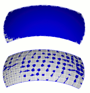

5.10.5 Smoothing a free mesh
Interior nodes can be smoothed using commands such as smooth hex all, or smooth tet all in block 100. These commands will smooth only the interior node on the elements used in the command. The nodes on the boundary will remain unchanged. To smooth nodes on a boundary, the target smoothing option can be used. Targeted smoothing allows the user to smooth a group of mesh elements to a surface or curve that is not their owner. Targeted smoothing is discussed under Mesh Smoothing.. The following sequence of commands illustrate the capability of smoothing a free mesh to a target surface.
sphere rad 25 webcut vol 1 plane xplane offset 18 delete vol 2 webcut volume 1 plane yplane offset 8 webcut volume 1 plane yplane offset -8 delete vol 1 3 surf 16 copy delete vol 4 surf 18 scheme pave surf 18 size 2 mesh surf 18 disassociate mesh surf 18
##Mesh and geometry overlap refine face 1 radius 3 set developer on
## Smoothing free mesh is a developer command smooth face all scheme laplacian
##Smoothed mesh is away from surface smooth face all scheme laplacian target surface 18 ##Smoothed mesh is aligned with surface
Figure 461: Smoothing without a target (above) and smoothing to a target surface (below).

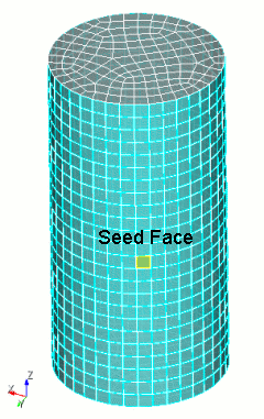

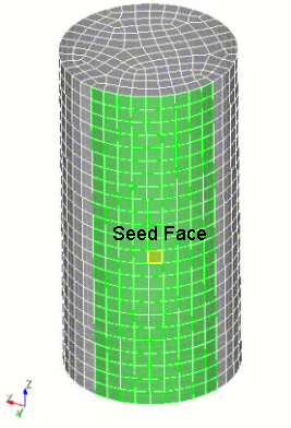

Assigning boundary conditions on free meshes can be accomplished by explicitly specifying mesh elements, by creating a sideset or block from the skin of a group of elements, or by creating groups based on feature angle using the seed method. Once the group is created it is easy to assign it to a nodeset or sideset.
Cubit will respect block, nodeset, and sideset data that is associated with an imported free mesh, or disassociated mesh. The following command sequence illustrates how the group seed operation could be used for assigning boundary conditions on free meshes.
##Creating blocks, nodesets and sidesets on free meshes cylinder radius 3 z 12 volume 1 size 0.5 mesh volume 1 disassociate mesh from volume 1 delete volume 1 group ’mygroup1’ add seed face 752 feature_angle 45 ##Groups all faces on the cylindrical surface group ’mygroup2’ add seed face 752 feature_angle 45 divergence ##Groups only faces within 45 degrees of seed face sideset 1 group mygroup1 sideset 2 group mygroup2 block 1 hex all draw sideset 1 draw sideset 2 draw block 1
Figure 462: Grouping faces on free meshes using the seed method. The feature angle method is used on the left with a feature angle of 45 degrees. On the right is the result if using the divergence method.
