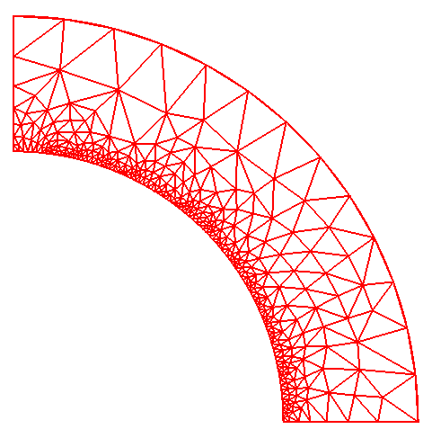

5.8.2 Bias Sizing Function
Surface <id> Sizing Function Type Bias Start Curve <id_range>
{Finish Curve <id_range>| Factor <val>}
Synopsis:
The bias sizing function for surfaces is similar to biasing curves. Indeed, setting a bias sizing function for a surface will bias the boundary curves, as well as control paving to follow the bias inside the surface. You first specify the size of a couple of bounding curves (the start curves), then specify the bias sizing function for the surface.
Recall that for biasing curves, you specify the start and end vertex. For the bias sizing function, you specify the start curves, from which to bias away. The sizes of these curves should already be set before setting the surface sizing function since their average size is taken to be the starting size (almost). If the start curve sizes change, then you should set the surface sizing function again.
You can either supply a geometric factor, or the set of finish curves whose sizes you want to match at that distance. A geometric factor. It automatically sizes and biases or dualbiases the non-start curves, including any finish curves. These curves need not be perpendicular to the starting curves. The interval count and scheme are soft-set, so they won’t be changed if they are already hard-set. If the size of the start curves or finish curves are changed, then the sizing function command should be re-issued.
The sizing function value at a point is defined in terms of the straight-line distance from the point to the closest starting curve. So, it works best if all the starting curves have the same size, and the surface is relatively flat. But, starting curves need not be parallel to one another. Similarly, the non-start curves need not have any particular orientation wrt the start curves.
The bias sizing function was designed to easily set the sizes of a sequence of adjoining surfaces: assign a size to the curve you want to bias away from, then set the bias sizing function of the first surface, with its finish curves being the start curve of the second surface, etc. See the last example below.

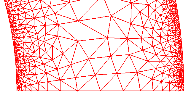

Figure 427: Surface with bias sizing function start and finish curve. Scheme qtri, base scheme pave.
# dual bias mesh
delete mesh
curve 25 26 size 0.02
curve 25 26 scheme equal
surface 19 sizing function type bias start curve 26 25 factor 1.3
mesh surface 19
zoom curve 12
pause
# see Figure 428
Figure 428: Close up of surface with dual bias sizing function start and finish curve. Scheme qtri, base scheme pave.

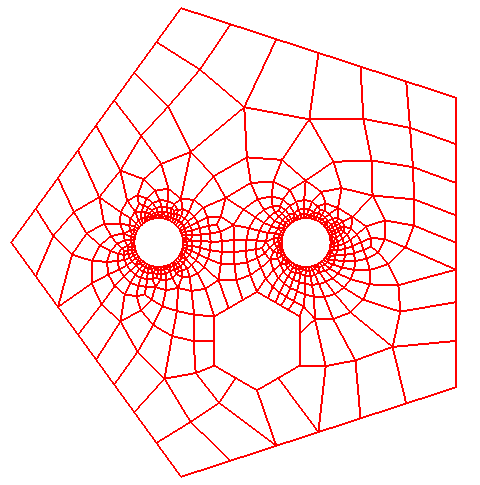

# funny face
reset
prism sides 5 z 1 radius 1
cylinder radius 0.1 z 1
body 2 move -0.4 0 0
subtract 2 from 1
body 3 move 0.2 0 0
subtract 3 from 1
prism sides 6 radius 0.2 z 1
body 4 move 0 -0.4 0
subtract 4 from 1
surface all except 34 visibility off
color vol 1 red
display
surface 34 scheme pave
curve 23 19 size 0.01
surface 34 sizing function type bias start curve 19 23 factor 1.3
mesh surface 34
# see Figure 429
Figure 429: Bias away from two round holes.

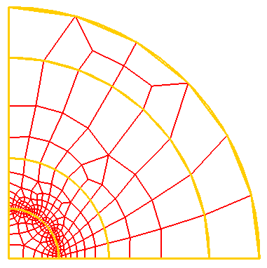

# bias surface chain
reset
cylinder radius 1 z 1
cylinder radius 0.2 z 1
cylinder radius 0.4 z 1
cylinder radius 0.8 z 1
imprint body all
delete body 2 3 4
section body 1 xplane
section body 1 yplane
surface all except 42 43 44 45 vis off
color volume 1 red
surface all scheme pave
curve 55 interval 36
surface 43 sizing function type bias start curve 55 factor 1.3
surface 44 sizing function type bias start curve 57 factor 1.3
# curve 57 had its size determined by a prior bias sizing function
surface 45 sizing function type bias start curve 58 factor 1.3
surface 42 sizing function type bias start curve 55 factor 1.3
mesh surface 42 43 44 45
display
highlight curve in surface 42 43 44 45
# see Figure 430
Figure 430: A chain of biased surfaces. Only one curve's intervals were explicitly set.

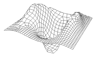

5.8.4 Curvature Sizing Function

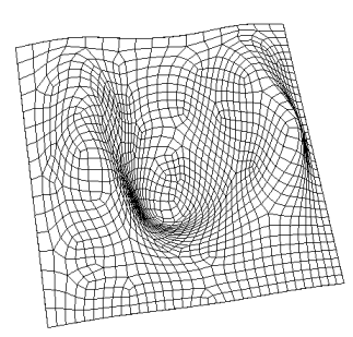

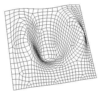

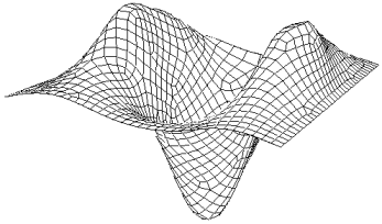

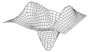

The curvature sizing function determines element size based on the curvature evaluation of a surface at the current location. Two surface curvature values (taken perpendicular to each other) are compared at the location of interest, and the largest is used as the sizing function for the mesh. Figure 432 shows a solid with a highly deformed surface which displays rapid change of surface curvature at several locations.
Figure 432: NURB solid with high surface curvature change
Figure 433 depicts a normal paved mesh of this surface using a common size on all bounding curves and no sizing function in the interior. The total number of quadrilateral shell elements for this case is 1988. Figure 434 shows a mesh which was generated with the curvature sizing function option. The mesh is graded denser in the regions of quickly changing curvature, such as at the tops of the hills and at the bottom of the valley. Due to the intense interrogation of the underlying geometric modeler which the curvature method relies on, this option can be very computationally expensive.
Figure 433: NURB mesh with no interior sizing function
Figure 434: NURB mesh with curvature sizing function

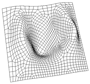

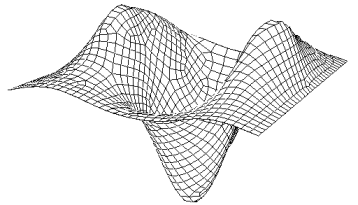

5.8.5 Exodus II-based Field Function
The ability to specify the size of elements based on a general field function is also available in Cubit. With this capability, the desired element size can be determined using a field variable read from a time-dependent variable in an Exodus II file. Both quadrilateral and triangle elements are supported for surfaces, but only tetrahedral elements are supported for volumes at this time.
A field function is a time-dependent variable in an Exodus II file. Either node-based or element-based variables may be used. Currently, field functions are imported from element and node-based Exodus II data. The mesh block containing the corresponding elements must be imported along with the field function data.

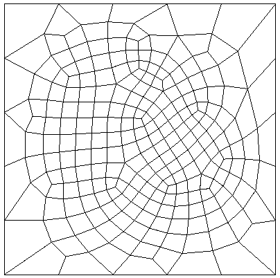

For example, the left image in Figure 435 depicts a plastic strain metric which was generated by PRONTO-3D [Taylor, 89] a transient solid dynamics solver, and recorded into an ExodusII data file. When the file is read back into Cubit, the paving algorithm is driven by the function values at the original node locations, resulting in an adaptively generated mesh [Attaway, 93]. The right image in Figure 435 depicts the resulting mesh from this plastic strain objective function.
Figure 435: Plastic strain metric and the adaptively generated mesh

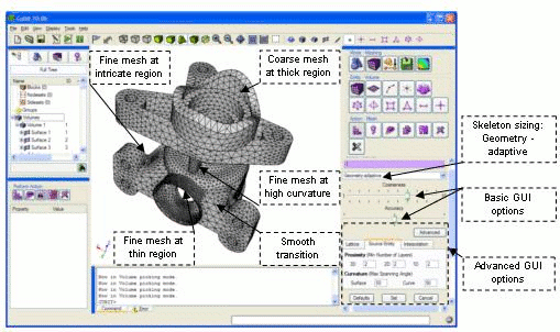

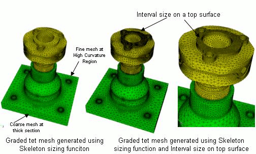

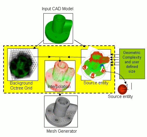

5.8.6 Geometry Adaptive Sizing Function (Skeleton Sizing)
The geometry adaptive sizing function, also referred to as the skeleton sizing function (Quadros 2005; Quadros 2004; Quadros 2004(2)), automatically generates a mesh sizing function based upon geometric properties of the model. This sizing scheme attempts to create a sizing function that allows unstructured meshing schemes to generate a mesh with the following properties:
The geometry adaptive sizing function can be used to create sizing information for surfaces, solids, and assemblies.
This sizing function uses geometric properties to influence mesh size. The scheme calculates or estimates:
These properties are then used to calculate a sizing function throughout the geometric entity (or entities). Regions of relatively high complexity will have a fine mesh size, while regions of relatively low complexity will have a coarse mesh size. For example, generally, a high-curvature region on a surface will have a finer mesh size than a low-curvature region on that surface
Figure 436: Overview of Computational Framework
Figure 437: Skeleton Sizing Function example in the GUI

Skeleton sizing can be specified on single or multiple surface(s)/volume(s) at a time from the GUI (Meshing Control Panel) or the command-line. The following describes how specifying sizing on entities can change skeleton sizing’s behavior:
Single surfaces/volumes – If skeleton sizing is applied to surfaces/volumes one at a time, each entity’s sizing is not influenced by the others. On the command-line, issue a separate command for each entity. In the GUI, specify only one surface or volume before selecting Apply Size.
Multiple surfaces – If skeleton sizing is applied on multiple surfaces together, then geometric features of a particular surface may affect its neighboring surfaces.
Multiple volumes (assembly sizing) – Skeleton sizing can be applied to assembly models so that geometric features of a volume may influence its neighbors. Volumes should first be imprinted and merged before they are specified together for skeleton sizing.

The skeleton sizing function is generated and stored on a background octree grid whose cells are subdivided based on the graphics facets of the model. The level of subdivision of the background grid affects how well the sizing function captures the geometric complexity of features. Reasonable defaults have been selected for the following two refinement (subdivision) parameters, but these may be overridden for use with simple (decrease parameters) or more complex (increase parameters) models.
5.8.6.4.2 Source Entity Arguments
Note: These arguments override the basic arguments. For example, time accuracy level 1 internally sets min_depth = 4 and max_depth = 6, and when min_depth is set to 4 and max_depth is set to 7 in the advanced options (recommended for models with fine features), then advanced options override the basic options. In the command-line, to override the depths set by a time_accuracy_level, specify min_depth and max_depth after it.
5.8.6.5 Skeleton with Other Sizing Controls
Skeleton sizing function produces a smooth sizing function when called with other sizing controls available in Cubit. Skeleton sizing function behaves as SOFT firmness level. Skeleton sizing function always respects interval count specified on the curves. Skeleton sizing function respects interval size on curves and surfaces only if it is specified after calling the skeleton sizing function.
Figure 438: Skeleton sizing function with other sizing controls

5.8.8 Inverse Sizing Function
The inverse sizing function is also similar to the Linear function, but this method bases edge length at a location on the inverse lengths of edges bounding the surface weighted by their inverse distance from the current location (see Figure 440). The difference between the three linear sizing functions (Linear, Interval, Inverse) is sometimes subtle, but is driven by the geometry being meshed since the influence of these functions is strongly controlled by the number, positioning, and mesh density of the bounding curves relative to the interior surface area.
Figure 440: NURB mesh with inverse sizing function, 34 by 16 density
5.8.9 Linear Sizing Function
The linear class of sizing functions determines element size based on a weighted average of edge lengths for mesh edges bounding the surface being meshed. There are several variants of this class of sizing function. The Linear function bases edge length at a location on the lengths of edges bounding the surface weighted by their inverse distance from the current location. The result of this weighting is a more gradual change in mesh density during a transition between dense and coarse mesh. Figure 1 shows the same NURB surface mesh but with intervals of 34 on two curves and intervals of 16 on the remaining two bounding curves and no sizing function. It can be observed that the mesh progresses more rapidly inward from the coarser meshed curves, which locates the transition region much closer to the finer meshed curves. To combat this, the Linear function weights the sizing of new elements such that these transitions occur slower. Figure 441 displays two views of the same NURB geometry with the same bounding curve mesh density using the linear sizing function.
Figure 441: NURB mesh with linear sizing function, 34 by 16 density

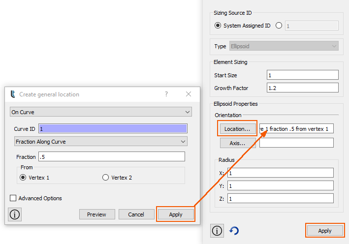

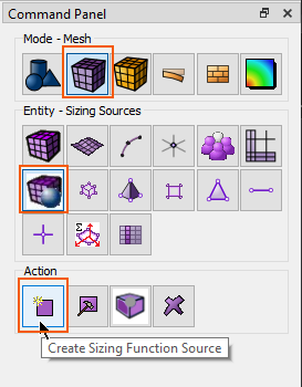

5.8.10.2 Possible workflow using the GUI
5.8.10.2.1 Create the sizing source ellipsoid
Figure 443:
Figure 444:
Figure 445:

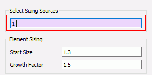

5.8.10.3 Attach the sizing source ellipsoid(s) to the volume(s)
After creating the sizing source ellipsoids the next step is to assign these sizing functions to volumes. Simply creating the sizing sources will not affect the meshing. In order to have these sizing sources act as sizing functions the sources must be attached (or assigned) to volumes.
Note: Use this same command panel to remove the association between Sizing Source sizing functions and volumes. Select the Remove Volume(s) radio button then click Apply.
Figure 446:

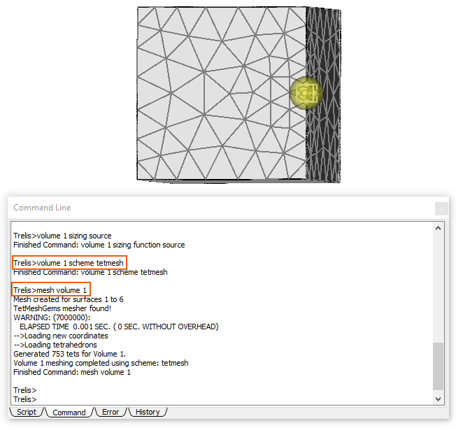

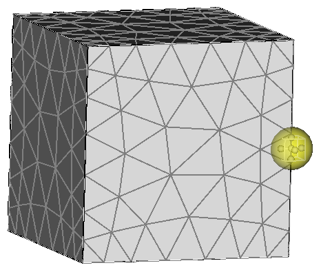

5.8.10.4 Set the volume’s meshing scheme to tetmesh and mesh the volume
Once the sizing sources are created and assigned to volumes, mesh the volumes using Cubit.
volume <n> scheme tetmesh
mesh volume <n>
Figure 447:

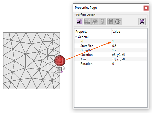

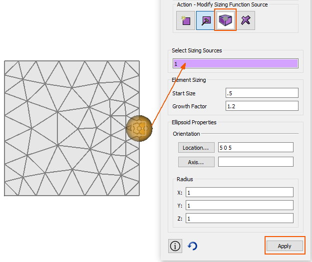

5.8.10.5 Modify a Sizing Source sizing function
An existing Sizing Source may be modified using one of several methods:
Figure 448:
  • From the Modify Sizing Function Source command panel
Figure 449:
Figure 450:

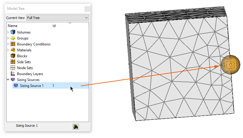

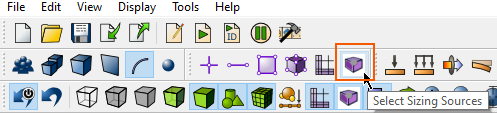

5.8.10.6 Selecting and picking a Sizing Source
Users may select a Sizing Source using several methods:
select sizing_source <id>
Figure 451:
  • Using the select filter on the toolbar then click on a Sizing Source object
Figure 452:
Figure 453:

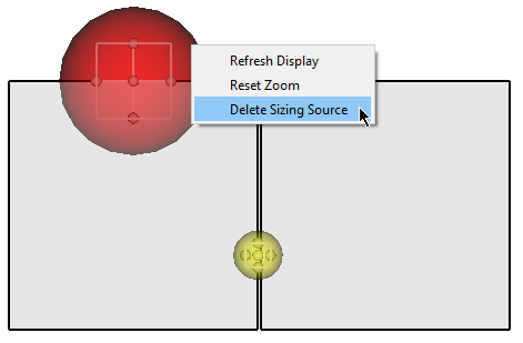

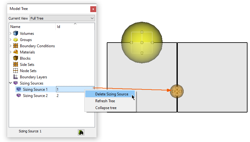

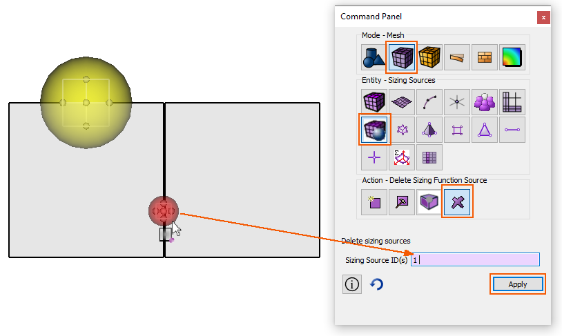

5.8.10.8 Deleting a Sizing Source sizing object
A Sizing Source may be deleted using several methods:
delete sizing_source id <n>
Figure 455:
  • From the Sizing Sources Delete command panel
    • The command panel supports deleting multiple Sizing Source objects with one command.
Figure 456:
  • From the graphics window when the Sizing Source select filter is active and Sizing Source is selected
Figure 457:
  • With the Delete key
    • After selecting a Sizing Source object in the model tree or in the graphics window press the Delete key on your keyboard.
