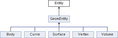

11.4.1  Inheritance diagram for Entity:
11.4  Entity
The base class of all the geometry and mesh types. More...
#include <CubitInterfaceEx.hpp>
