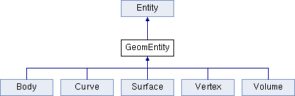

11.5.1  Inheritance diagram for Geom  Entity:
11.5  GeomEntity
The base class for specifically the Geometry types (Body, Surface, etc.) More...
#include <CubitInterfaceEx.hpp>
11.5.1  Inheritance diagram for GeomEntity:
