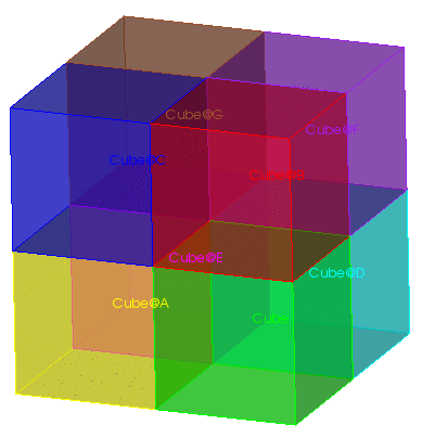

4.11.2.5 Automatic Name Propagation
CUBIT automatically propagates names through webcuts. If an entity that has been assigned the name "Gear" is split through webcuts, the resulting bodies are named "Gear" and "Gear@A". Try the following example.
br x 10 volume 1 name "Cube" webcut volume 1 xplane webcut volume 1 2 yplane webcut volume 1 2 3 4 zplane label volume name
Figure 216: Name Propagation through Webcuts
You can operate on these propagated names using wildcards such as:
mesh volume with name ’cube*’
block 1 volume with name ’cube*’
