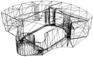

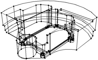

Facets are simply triangles that have been stitched together to form surfaces. Faceted geometry representations are commonly used for graphics, bio-medical, geotechnical and many other applications that output a discrete surface representation. Upon import, the resulting geometry representation is Mesh-Based Geometry. Figure 217. shows an example of a faceted model and the resulting geometry created in Cubit.
Figure 217: Example of faceted model and the resulting solid model created in Cubit from the facets.

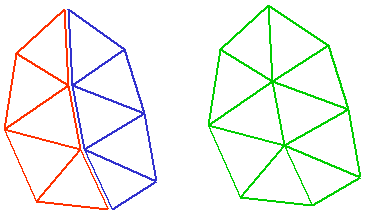

4.15.3.6 Stitch
The stitch option is used with the facet or avs format files to try to merge vertices and triangles that are close. Figure 218 shows an example of where this might be employed. The model on the left contains facets that are not connected between the red and blue groups. In this case, the surfaces will not be water-tight, even though the vertices on the boundary between the two groups may be coincident. The stitch option attempts to eliminate the extra edge and vertex between the groups to form the model on the right. This option can be useful when importing facet files for 3D meshing. Cubit’ 3D meshing algorithms require a water-tight (closed) set of surfaces.
Figure 218: Example use of the stitch option on import.
