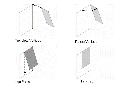

The fourth form of the command uses vertex pairs to define the transformation. The first pair of vertices define a translation so that the source and target vertices are coincident (i.e.,the source is moved to the target). The optional second pair of vertices define a rotation such that the source and target vertices are all collinear after the transformation. The optional third pair of vertices define a rotation such that all the source and target vertices will be coplanar. If the target vertices happen to be moved as a result of the alignment, the source vertices are moved such that they align with the original coordinates of the target vertices.
After the alignment, the first vertex pair will be coincident, the collinear vertex pair will be collinear, and the third vertex pair will be coplanar.
{Body|Volume|Surface|Curve|Vertex|Group} <id_range> Align Using Vertex <source_id> <target_id> [Collinear Vertex <source_id> <target_id> [Coplanar Vertex <source_id> <target_id>] ] [include_merged]

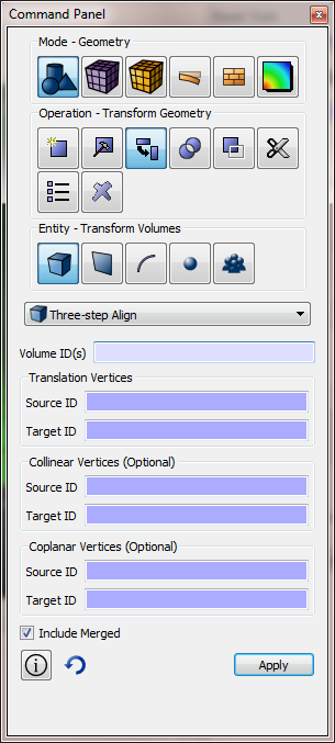

4.3.1.1 Align (3 Step)
Beginning with Cubit 16.0, the command panel Align (3 Step) is included in the GUI. This new functionality is accessed via the command panel user interface in Cubit 16.0 and via the command panel and the command line in subsequent versions of Cubit.
Figure 135:
This functionality is available for volumes, surfaces, curves, and vertices.
